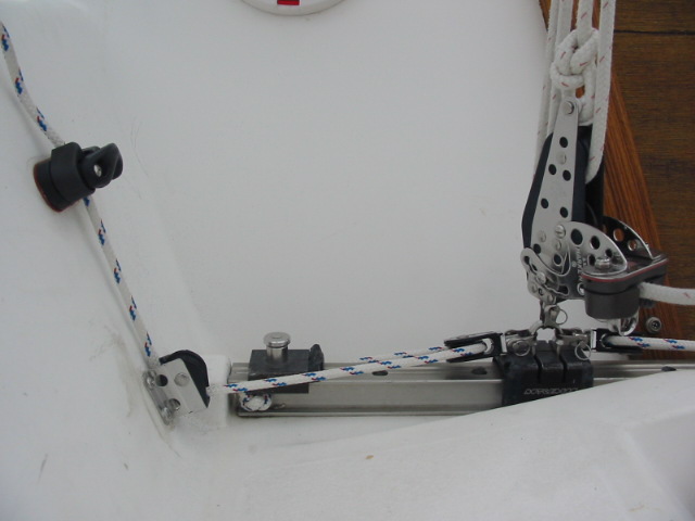

I don't have any pictures, I might be going out to the boat on Wednesday and I'll take some. I'll try to describe it for you. First I did not remove the track or car. Move the stops to each end, then attach two Harken 166 single/swivels to the eye strap that the Main sheet tackle mounts to. Mount a Harken 096 upright lead block on the seat back on each side an inch or so above and over from the end of the track, above that mount a Harken cam cleat. Drill a hole in each end of the track big enough to pull your new traveler line thru. Tie a stopper knot, reave the line thru the 066 then to the 096 and up to the cleat, Instant 2to1 purchase and adjustable traveler. Clear as mud, right? You will want an eye strap on the cam cleats to keep the line with the cleats. You could mount an eye strap on the other side of the end of the traveler to dead end the lines (instead of the hole in the traveler) but I thought the less holes drilled thru the boat the better.

Picture of inexpensive traveler upgrade
Here is the picture of what I did to upgrade my stock traveler without removing the track or car. If you single hand often you could angle the upright block and cam cleat towards the back of the cockpit. I didn't do that for the comfort of having more people in the cockpit, nobody likes a cam cleat in the back. With a tiller extension I can single hand and still work the traveler just fine. If you wanted more purchase you could mount a block on the other side of the upright block and then use a block with a becket on the car, that would give you 3to1 purchase.

Very nice traveler modification
Simple yet effective. Now I wish I had procrastinated. Peter H23 "Raven"

The Flying Scot is the best daysailer ever built. Period. Any boat with that kind of performance and will hold six adults and float in eight inches of water is pretty special. I was glad to see it was inducted into the Sailing Hall of Fame last year. If I find one at a decent price I'd probably buy it. Check the Photo Forum for my H23 traveler mod, Quite frankly I prefer John's version because you don't have to take up the track or remove the existing stops. That cuts the amount of work subsantially. His setup also allows you to adjust the traveler from the coaming, a very nice feature that I haven't been able to do with mine. I'm seriously considering adding the turning blocks and cleats that he did. My mainsheet tackle (Harken) has the sheet exit at the bottom with the cam cleats upside down so I have to snap down to uncleat the mainsheet. This setup helps when sailing close-hauled because the H23 main is very powerful and even with a 4:1 tackle you need to sheet in hard to get that last bit of trim. Now I use the traveler to get the right angle of attack. Since the mainsheet tension isn't as hard, the leech of the sail is more open and I have less weather helm (and more boatspeed!). I find sailing an H23 very similar to sailing a Scot. The H23 is pretty light (2300 lb) so I can still use my weight effectively to trim the boat and get the maximum effect from the available sail power. On a beam reach in a decent breeze the H23 will plane just like a Scot. My personal best is 8.6 kt and Greg S. in Texas reported speeds over 10 kt. Ease of mainsail control is a big part of this. Peter H23 "Raven"
