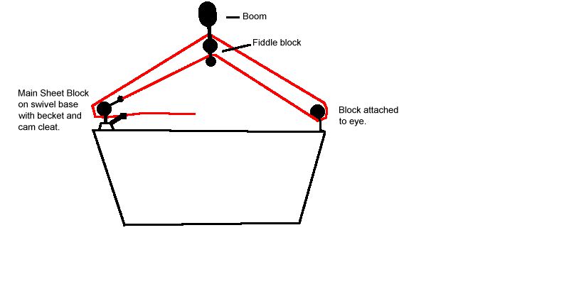

I'm home now and can post it.
Sometimes a diagram is easier to understand.
I would recommend setting up a traveler. I will post a pict of mine.

That was it, your diagram was exactly what I needed. I like your current option as well. I also have a Tanzer 22 that has a similar setup. It is connected to the floor of the cockpit, but it is fixed to one point in the middle. It is handy because I can operate it from the stern while one hand is on the tiller.
Thanks again, Dean

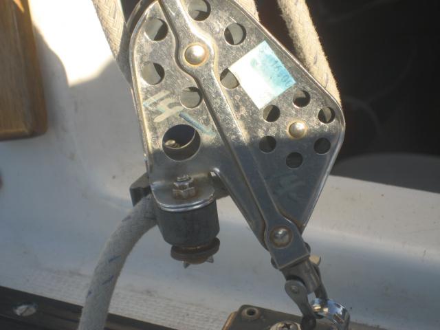

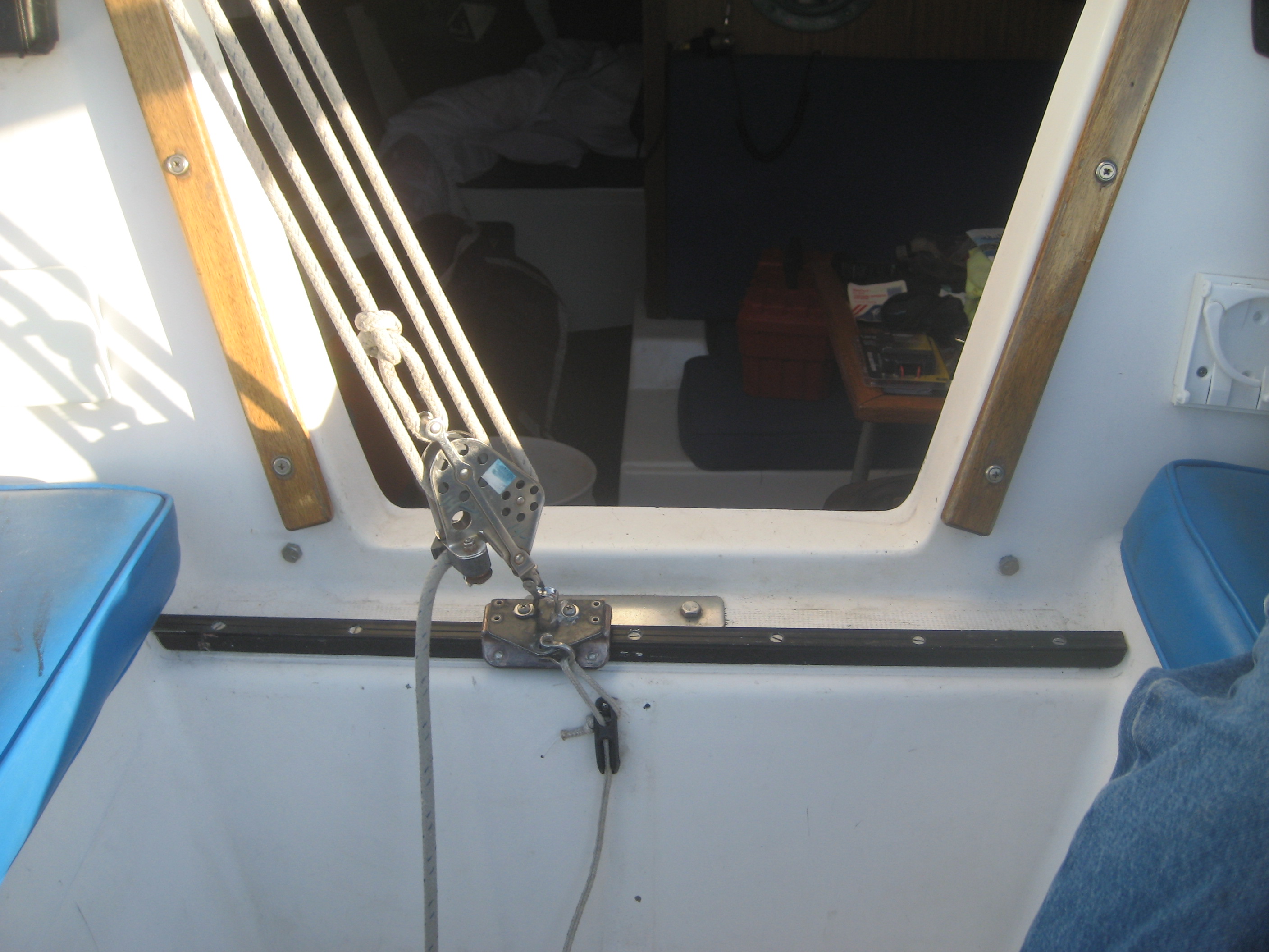

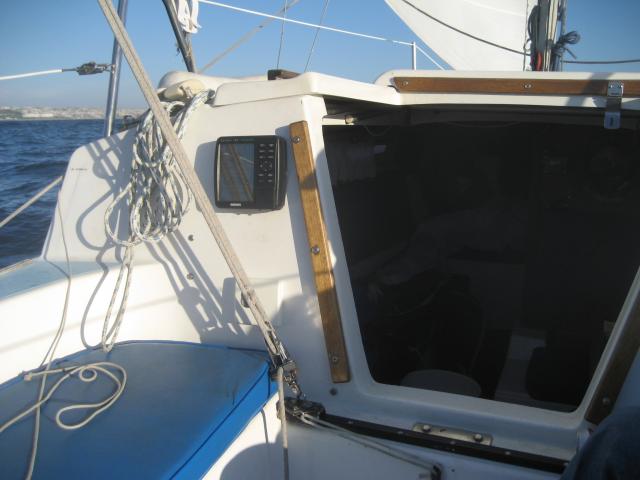

Here are some picts of mine. Stole it from my old Hobie set up. In fact the car came from my old Sol Cat. I have changed the setup to use a Spinlock cleats at each end. This allow me to pull the block past center so that I can bring the boom closer to center. Since I can't get to my boat ( :cry: still locked up) I don't have picks or it.
When you set up the vang bail remember to locate on the boom to clear the top when the pop top is up. On mine the top swings aft about 6".

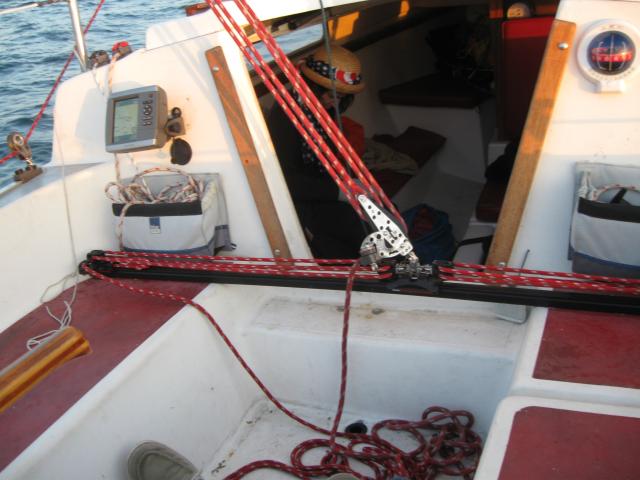

Whether it's worth the trouble to set it up is a descision only you can make, I can see the difference in how the boat sails in using different combinations of mainsheet and traveller, it's training for a bigger boat, the track doesn't get in the way, if it did, I would hear about it :snooty: from the boss, all the controls are in front of you, It's easy to move the main sheet out of the way for cabin access if necessary.. I really hated the original setup, made for really nasty jibes. Here is a pic of mine finally.
