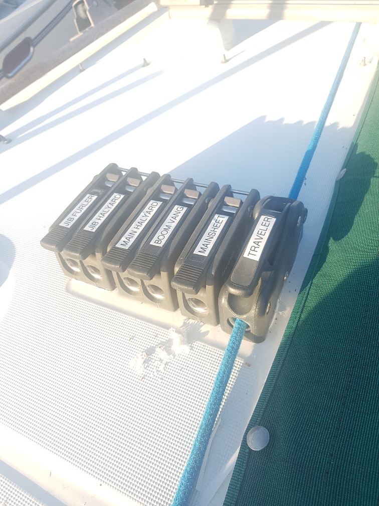

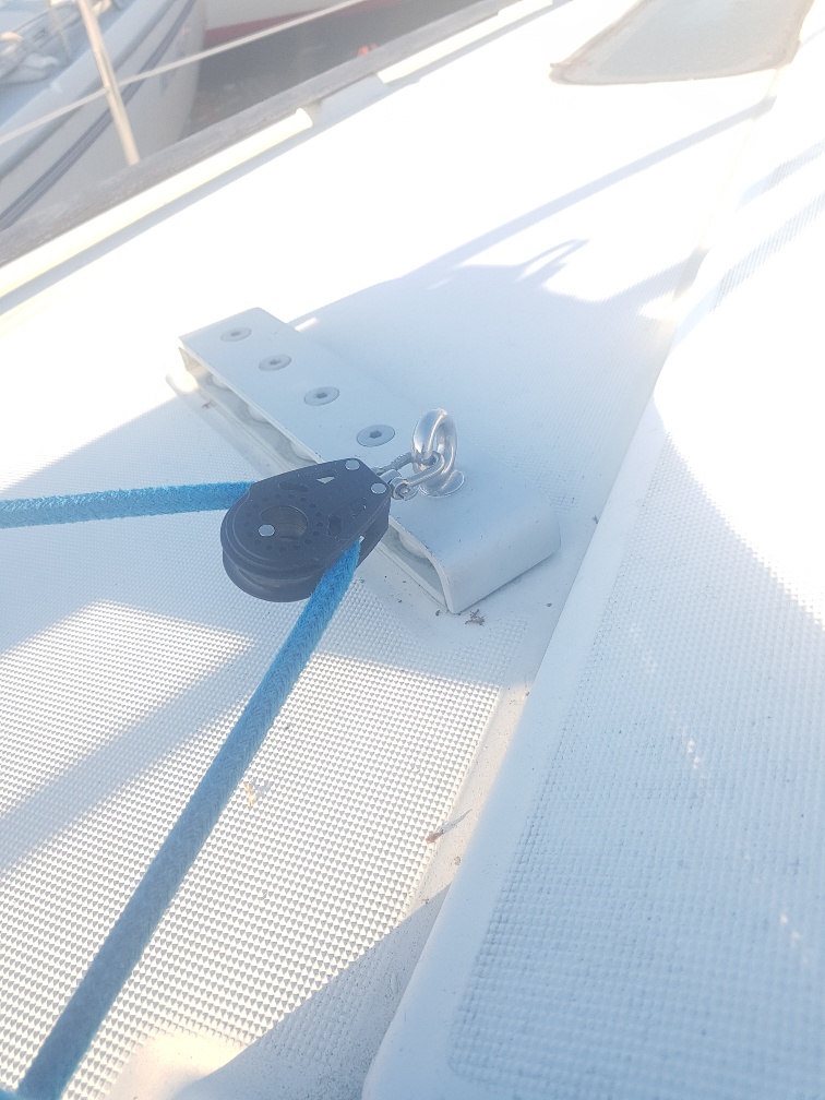

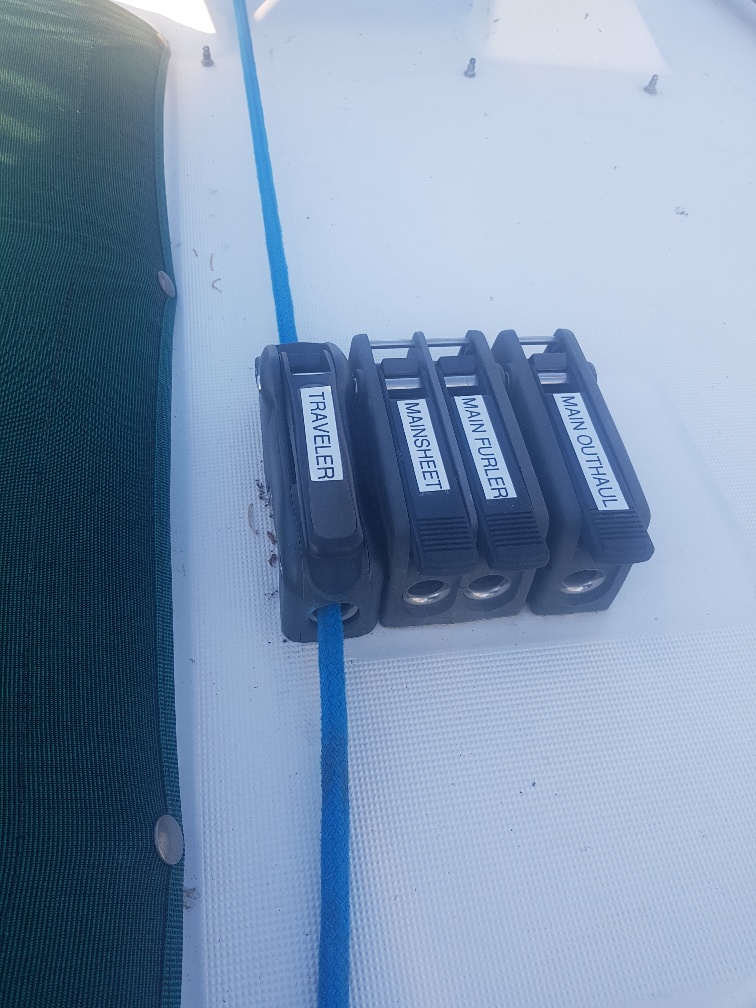

I copied Jokers 460 traveler mod with a few updates ,instead of drilling and tapping line organizer ,I removed one of the m8 flat head bolts and replaced it with a 316 stainless m8 eyebolt and added 2 x40mm blocks and 2x clutches
