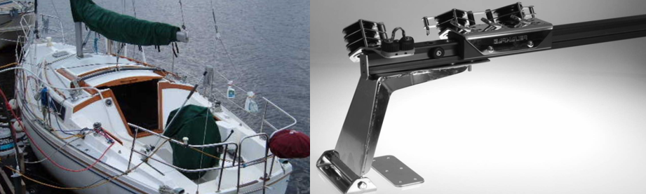

I like a straight vs. arched traveler since it is not likely to get hung up I assume you want to replace the "arched" traveler over the companionway cover shown in the left photo to a straight traveler like the one shown in the photo on the right (Catalina Direct C30 Mid Boom Traveler Upgrade Deck Mount Traveler C-30 Mid Boom TravelerUpgrade Deck Mount (catalinadirect.com).

Thanks for the information ... It does look like the pulling angle would be off. I will still have to lift up the teak supports if I use them as the straight traveler will still hit the curve of the hatch cover.

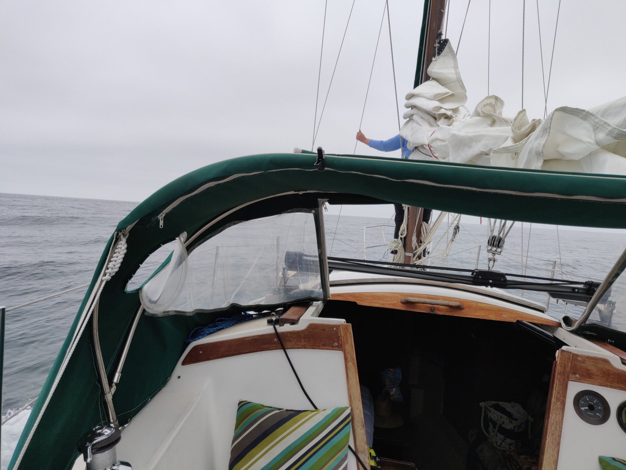

Hayden: Thank you for the picture. I didn't know the term (turtle) so I left that out of my reply but I was wondering why anyone would want to extend the front edge of the dodger way beyond the edge of the turtle? I wouldn't want it short of the turtle. A couple of times coming back from Catalina Island on cold rainey nights I wish I'd have extended the dodger farther aft. Folks below are warm and toasty and I'm wet and freezing -- they ask if I want a hot coffee. What I really want is for one of them to sub for me at the helm.

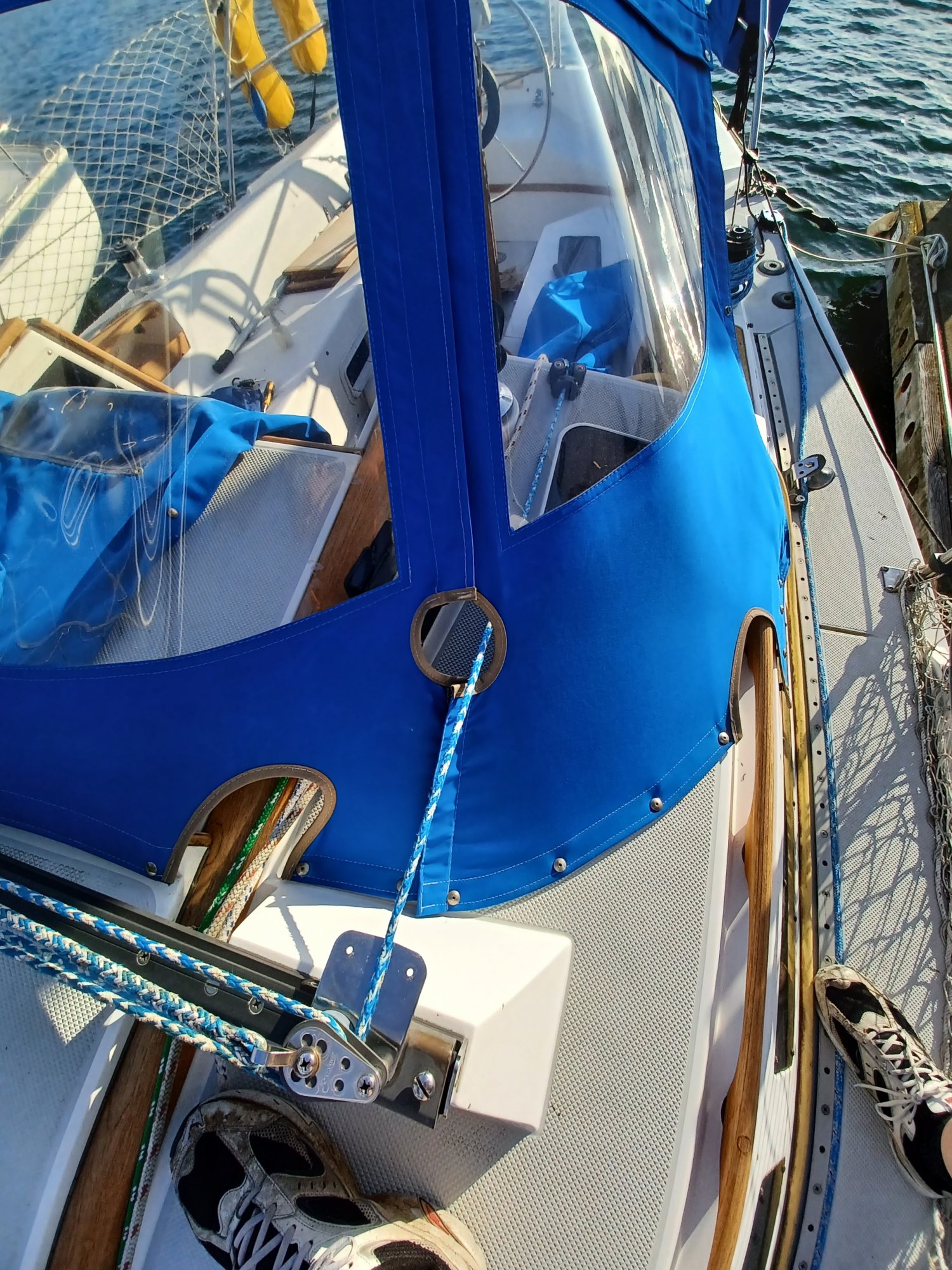

I can understand your desire to extend the dodger to the turtle if it now stops on the sliding hatch. The center panel of my dodger is connected with 5 snaps to the lip on the aft edge of the turtle so that no wind comes through. We are in the PNW and can sail 12 months of the year IF you have good heating. A couple of years ago, I installed a hydronic system and am now planning to have a full cockpit enclosure made and will add a heater to create a heated cockpit for the ultimate in winter cruising.
Hayden: Nice idea on a heated cockpit. Didn't need one in So Ca but what I wished I had was a set up where I could lay it over the boom for sun protection. I used a tarp but it looked like something from the Beverly Hillbillys.

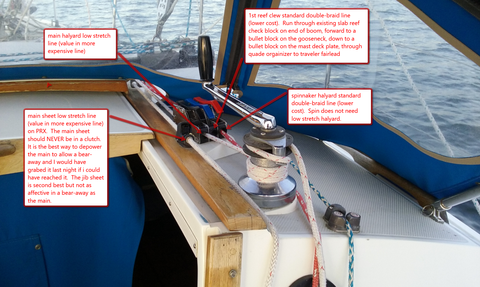

I noticed your fairlead car - I think it's a pin type. As you know Garhauer makes an adjustable system, which is the 2nd mod I made after getting rid of the curved traveler. It's almost self adjusting but not exactly. I found on my boat that it had to come aft a bit from the point it sets at. I rigged up a system to accomplish that.
I noticed your fairlead car - I think it's a pin type. As you know Garhauer makes an adjustable system, which is the 2nd mod I made after getting rid of the curved traveler. It's almost self-adjusting but not exactly. I found on my boat that it had to come aft a bit from the point it sets at. I rigged up a system to accomplish that.
I have lusted after the Garhauer adjustable jib cars but have not fitted it into the budget yet. I move my cars all of the time and am fussy about lead car position but am able to do it without the expensive cars. If I am racing, I change it on the onloaded side if I have a tack coming up. I can also ease the sheet a few inches and walk down the line to unload the car and move it. This is much easier to do on the Mk2 with the inboard T-track.
