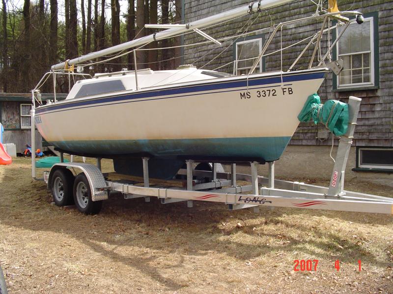

As long as the centerboard can fit all the way up into the keel slot without hanging down below it, and most of them do because they were built, there is no set height. The hulls on these boats are built strong and your boat's lead keel could sit directly on any hard surface without worry of it going through the hull. I know that mine can but with that said, it's better to have the hull and keel equally supported. Some sloops are designed for flat bunk trailers and their hulls weren't designed to have the boat's full weight supported by the keel. Not so with these O'Days. These boat hulls are strong enough to take a compete roller trailer or a flat bunk trailer.
The keel on my 1986 O'Day 222 which is a keel/centerboard like your O'Day 23, hangs down approximately 8" and my "Long Mfg" Aluminum tandem trailer has 24" extension brackets holding the bunk boards. My brackets are set at various heights of between 19" and 20". It really depends on the type of trailer and the type of cross members. Some cross members are curved and some are straight like the ones on my trailer.
What are your plans Herco? Are you going to try and buy a boat trailer that will fit your boat or are you planning on renting a flat bed trailer and having a cradle built to support the boat for the trip home?
The depth of the keel shall determine the height of the cradle supports and this could be anyone's guess as there are so many variables to consider.
What you could do is go to a large trailer dealer in your area and talk to someone who is knowledgeable. Chances are he has all the specs of your O'Day 23 right in his PC and he will try to sell you a sailboat trailer that will fit your boat or maybe provide you with the info needed to convert one of his new powerboat trailers into a sailboat trailer.
Years ago when my Load-Rite roller trailer bit the dust I went to a Long Mfg dealer in Warren RI and he set me up with a new tandem powerboat trailer that could take the weight of my boat plus, with the 24" extension brackets and a couple of sandwiched pressure treated planks for my keel to rest on, I was able to convert it over to a sailboat trailer.
My boat weighs about 2200 lbs and the trailer is good for 4600 lbs.
Also, my boat is about 21' 9" and my trailer can take a 23" boat. This is important because with a longer trailer I can float my boat on and off without having to swamp my truck or have a need for a tongue extension bracket on the trailer.
The extension brackets that originally came with my trailer were only 8" long. Fortunately I was able to swap them for 24" brackets and he had them right in stock. They were the best made brackets on the market, I think. I'm not sure if Long is still in business. There is talk that they are starting back up in NC. Anyway, I bought the planks and mounted them myself. Even if you don't buy a trailer off this dealer, the info you're that he's going to provide will help in finding a trailer that will work for you. If you need any more info on my set up, let me know and I'll provide it to you.

My other trailer had a rack with four 12" amber colored keel rollers with 18"X5/8" pins w/ pin buddies and most of the weight was on those keel rollers. The hull rollers supported the hull and acted as a guide, especially the back roller which could conform to the shape of the bow as the boat was being loaded on the trailer.
I'm pretty sure that most of the weight of my boat sitting on that trailer is on the trailer's keel boards.
Your boat looks great. My friend Rudy told me years ago that the O'Day 23 was one of the best boats that the O'Day factories ever built. I'm inclined to agree with him on that. He worked for O'Day back then and I figure that he should know.

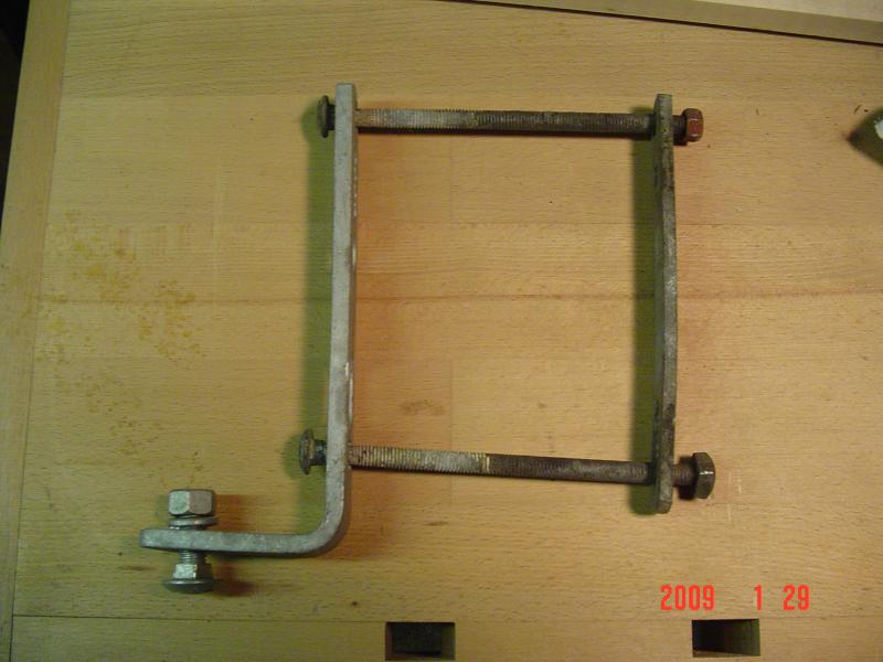

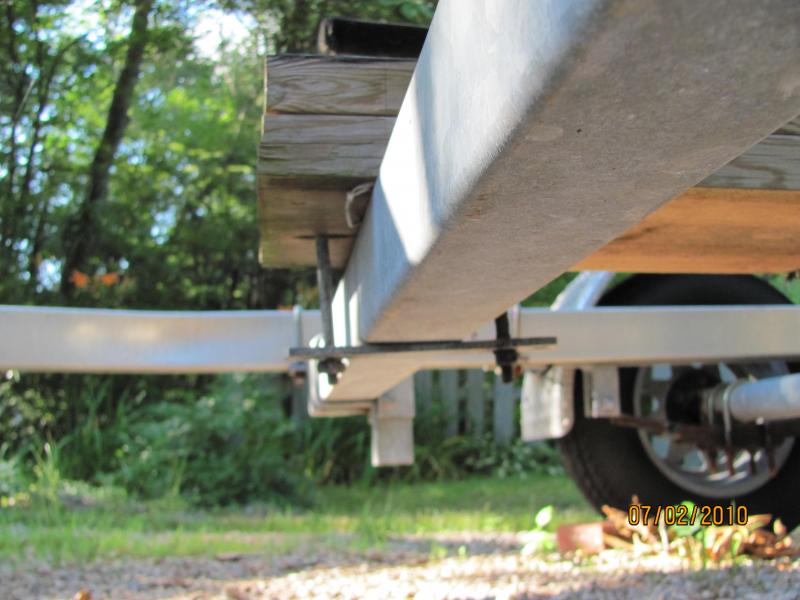

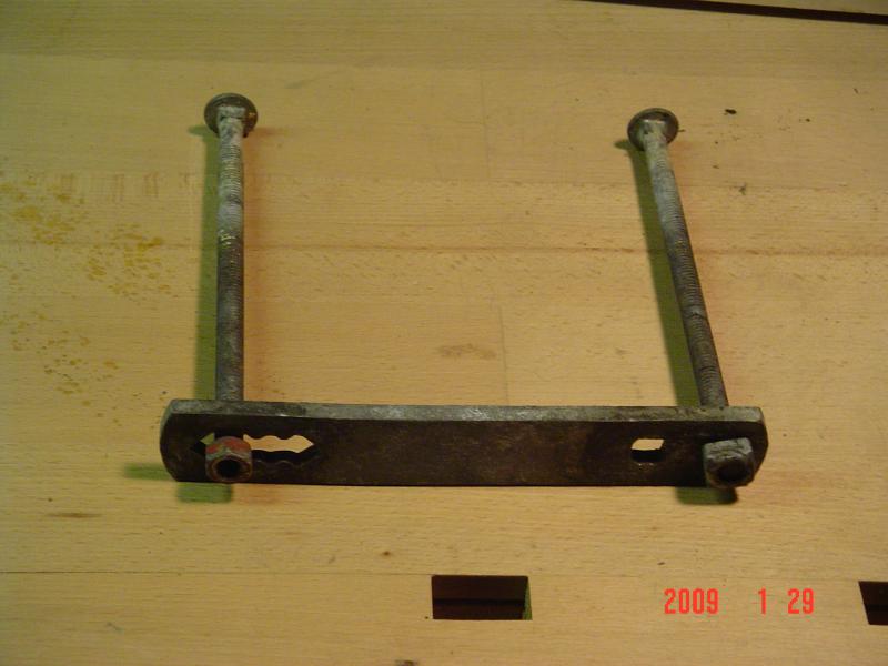

You don't even need to drill holes into the trailer's cross members to hold these sandwiched keel planks. I used two galvanized brackets that I picked up at my local electric light department at their distribution center. These brackets are built for mounting high voltage fuse cutouts, lightening arresters, and URD high voltage terminal connectors (Pot Heads) to telephone pole cross arms.
A lot of times they don't use the whole bracket if the poles don't have cross arms and they just bolt these devices to the pole with a 12"X 5/8" bolt.
Consequently they will throw the back plate and the two 3/8" carriage bolts, nuts w/washers away. If you ask them for a couple they'll probably give them to you. They are galvanized steel and they will last.
I countersunk the top keel board for the carriage bolt heads so that the keel wouldn't hit them. If you look at the pictures, I installed a carriage bolt through the planks on each side of the trailer's cross members and used the slotted back plates to secure the keel boards to the cross members.
I put some Never-Seize on the bolt threads to insure that I can loosen the nuts on the carriage bolts. Each back plate has one hole for the carriage bolt on one side and a long jagged slot on the other side so there is no accurate drilling required.
I raise my boat every year and put her on stands, so being able to loosen the keel boards and move then to one side out of the way, really helps in getting my boat on and off the trailer to my boat stands.
