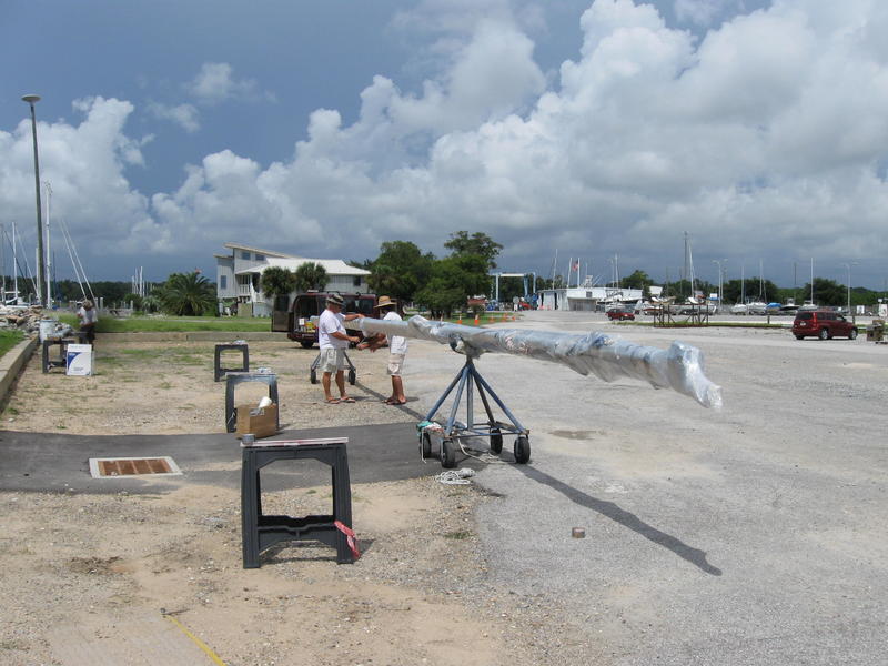

Make sure that the shrouds are individually wrapped in some heavy martial like carpet pad or the like be for wrapping it all up. I paid a shop in FL to wrap mine for transport and they just tigtly wrapped everything together in shrink wrap, but on a 1500 mile trip the SS cables left a few cable marks on the spar.
I pulled my main, but I am not sure that you need to.
Other than that not a big deal.

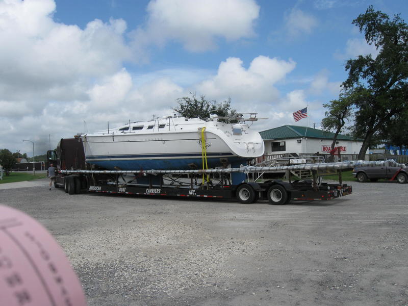

I pulled my main, as it is not that hard to do. I figured it was one less issue to deal with. The Yard security guard helped me fold it up.
The rigging crew, and I use that term very loosely, hired the yard crane to pull the mast and arch. I had already pulled the boom and removed all but two bolts from the arch and had disconnected the speakers and lights. I had un-wired the mast connections too. Other than the heavy weight of the mast it is not very complex.
Make sure that you get a quote for the work. I bought during the great recession, and they tried to double my bill, cause I things were slow, and I was going north. Really left a bad taste for FL.

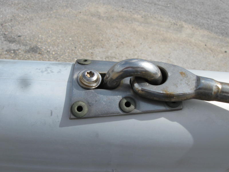

We loosened up the diagonals, pulled the spreader end pins, but left all of the shrouds and diagonals connected. It really saves time and confusion when re assembling the mast. Spreaders were removed. The jib furller was removed, but wrapped with the Mast as a bundle. Make sure that you Visualize the attach point for the fore stay, as it is easy on the ground to put the locking pin in the wrong place and effectively set your self up for a fore stay failure.
