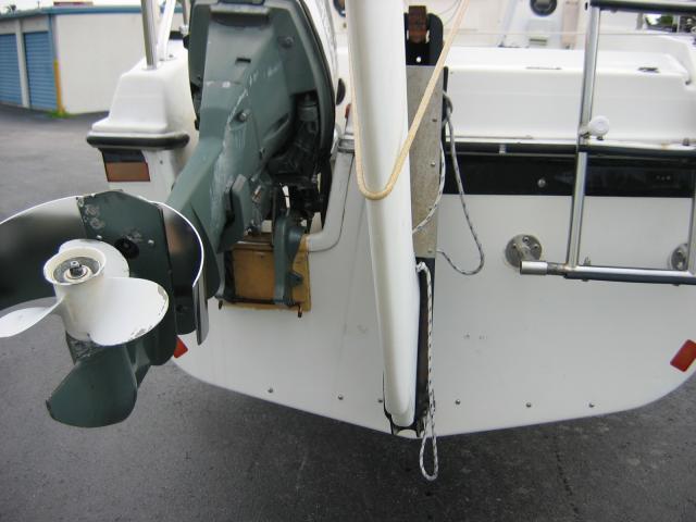

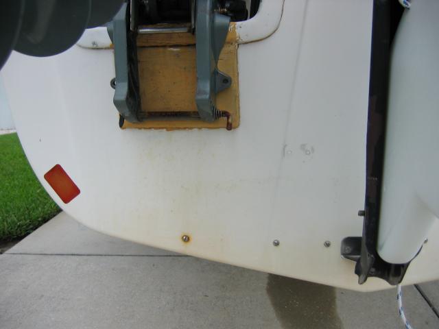

When you do replace the trim, I'd suggest putting a backing on as the previous owner of Soire'e did. It keeps the motor from moving forward and back- at all. I'm not sure I'd have thunk it, but it sure makes the motor solid.

JDK, what are the screws for on the bottom of the transom? Backing plates?
fwiw, I shimmed my engine to move the center of piviot rearward to get a little more travel.
Those are holding the rear of the floor of the lazarette. If you look closely, you can also see the inspection plate just under the edge of the anchor chain. That's where one gets access to the speed meter sending unit, or to sponge out any water that happened to get in.

I reconstructed the fiberglass trim. Then placed a hard nylon cutting board (from supermarket; cheap and super sturdy) as backing plate and bolted the motor right through with ss bolts, which were cemented with 3M 4200 like beamreach described. I used a 3/4 in HDPE plate and ss washers as backing on the inside. Been more than 2 years like that and looks super; no more headaches with cracking the trim, etc. Nylon cutting boards are excellent for this job, but require a slow-cutting implement. Jig saw and table saw cause a lot of melting as they cut through. Cheers, Albert
