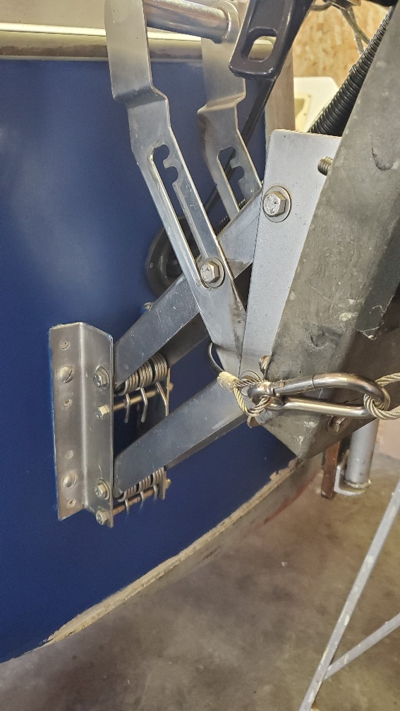

hefty aluminum L angle from big box installed vertically works, or what Dave sez, I simply used jumbo galv fender washers....https://www.mcmaster.com/galvanized-steel-washers

Support rails are normally mounted vertically. As @rpludwig said, angle aluminum or stainless. CD's version is stainless, and pre-drilled for the standard Garhauer mount (the holes might or might not fit your motor mount's spacing - call CD to confirm; they're very helpful). Stingy Sailor used aluminum (scroll down in that page for a picture). I wanted to avoid bimetallic corrosion between stainless fasteners and aluminum rails, so I went with the stainless. And, being somewhat paranoid, I added a big G10 plate as well. Hope that helps a little.

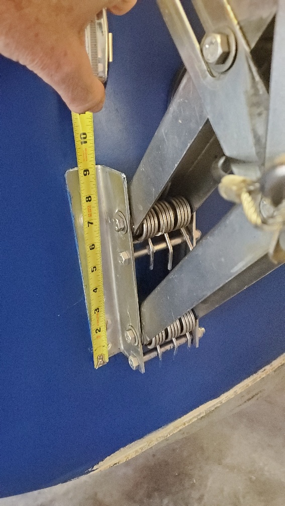

On the plywood front: relatively easy to work up a 3/4 marine ply backer-- coated in epoxy and bonded to the inside of the transom:
Ideal for motor mount and gudgeons.

Thanks guys. Good advice. I am sure that the transom was initially designed to withstand the rigours and mechanical forces of that motor attached to the blunt end of the boat, especially when in the 'down' position and extended further away from the transom. But over time, I suspect that the wood core is not quite as it was when new so trying to avoid a catastrophic failure. Any means to distribute the load and avoid higher stress points such as the 4 mounting bolts is an improvement. I like the angle alumINIUM approach, as well as the backing plate. I have marine ply so maybe both, if i can find high tensile bolts long enough. Cheers !! Hopefully we can get boats in the water and be able (allowed) to play soon !! But better we stay away and be healthy, to play again some day with luck.
