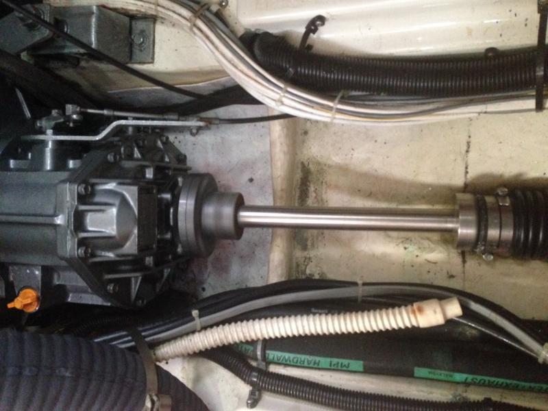

i think i'm having issues with my transmission on my 93 40.5.
The engine is a standard Yanmar 4JH2E.
last time i went out, i had to apply more power than usual to move the boat around in the marina as it was very breezy.
I heard a couple of "clunkling" noises when i switched in reverse and gave it a short burst at 2000RPM.
Now the engine will not rev up past 1600RPM when it's engaged in rerverse. It is fine is forward gear or at idle. I checked the throttle cable but don't think it is the issue
any ideas?
