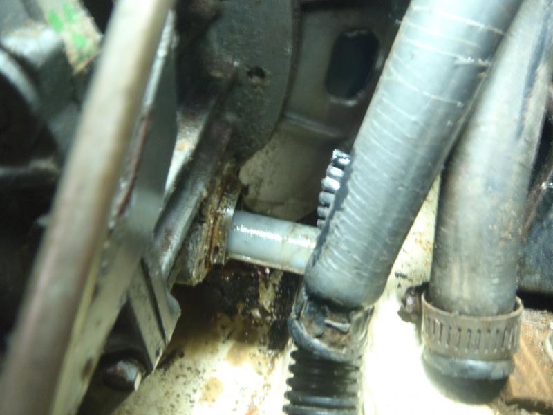

these are some photos of how far I got..........I took the inlet and outlet housing off and there is a plastic tube that wont come out because there is no room.................I still dont understand how it works

I pulled the tanny out today...............by myself it took 3 easy hours, just scrathed 1 knuckle............its off to service....
ps. if you have a hunter with this problem, you will have to pull the tranny
