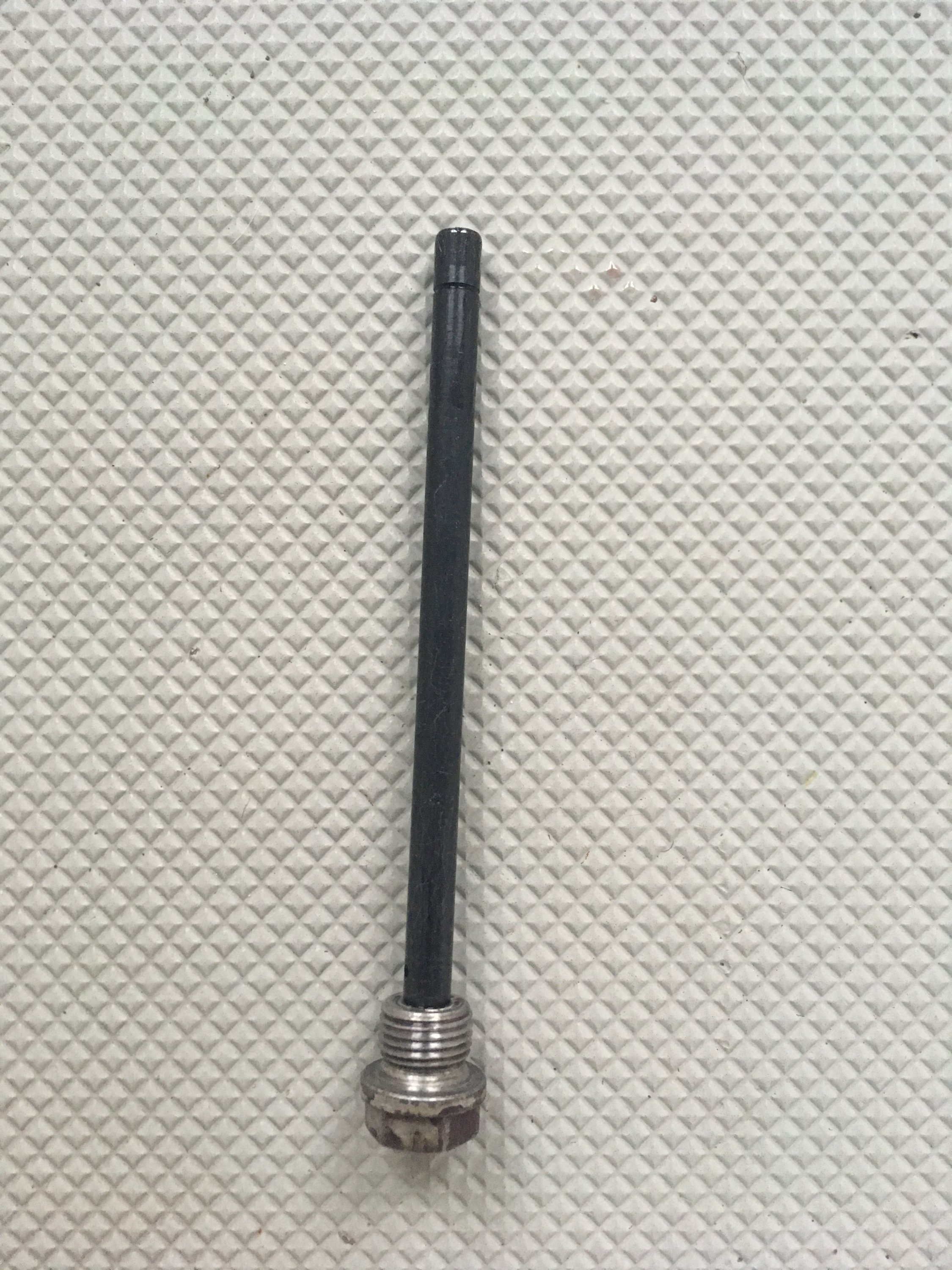

2. I'm not clear how the dipstick works. Photo below. First off, what are the markings for high and low? The dipstick is about six inches long with a score around the tube maybe a half inch from the bottom. If I'm keeping it in that narrow band it seems a poor design. When the oil level is low does it simply disappear? My second problem is it's a challenge to read the thing because it is black. I'm not sure any oil is on it at all.

1. Don't know, keep checking, but see #2 below. By manual, do you mean the engine manual? If so, it won't have that info, you need the transmission manual. Try looking at the Hurth manual here: http://c34.org/wikiwp/?rdp_we_resource=http://c34.org/wiki/index.php?title=Manuals
2. Reading dipstick: roll it on a paper towel to see the amount. Almost all Hurth transmissions say to leave the dipstick not screwed in, just resting on the top of the hole, to take the fill measurement.
3. Nope: engine off, no need to even warm it up.

+1 to Stu's post. Engine off, pull stick & clean it off. Plug it back in but don't screw it in. A flashlight helps to see the oil on the stick.
I believe HBW50 takes about 0.29 pints of type "A" ATF. I think the info is in the engine owners manual...
If you can't see anything on the stick then you've got serious problems
