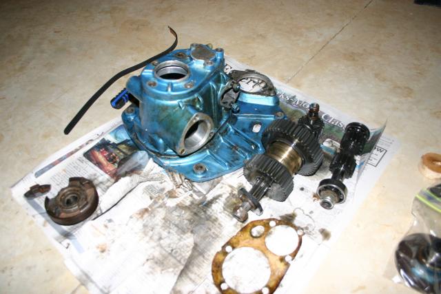

Thank you for the speedy reply. I will relay this info to the hubby.;) Also, thank you for sending a pic of the disassembled motor. Thank you again.

That's just the transmission and it's internal guts. Not much too it really. I took it out to rebuild it cause it leaked oil out of the rear seal (at the output shaft) when running. Unfortunately the new seal (and bearing) did not fix the problem. Anyway, Kloudie is correct, you don't need to disassemble the transmission, just remove it from the engine and using a gear puller remove the coupler or the flange (depending on which seal you are replacing).
