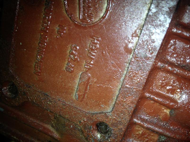

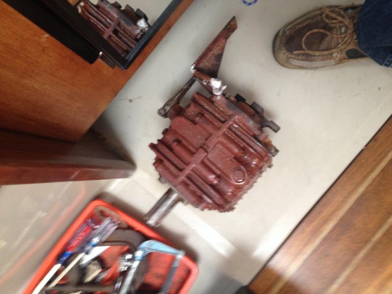

I just replaced a transmission on an o'day 39. It has a Universal engine but I believe the transmission is the same. Get your cell phone out and take a few pictures to find out for sure. I attached a photo mine. One photo shows the model info. You are looking for HBW-(10, 12, 100) or something similar. The other photo shows the transmission from the top. You can see one of the four bolts holding the shifter plate on.(it's on the side with the shifter arm) remove these four bolts and the plate and shaft with the shifter arm come off in one piece.
Assuming it is a hurth:
The shifting mechanism is on is own plate attached to the side with four bolts. You can then have the plate sent off to have the shaft (shifting) seal replaced. You will want to also replace the gasket for where the plate attaches to the transmission.
