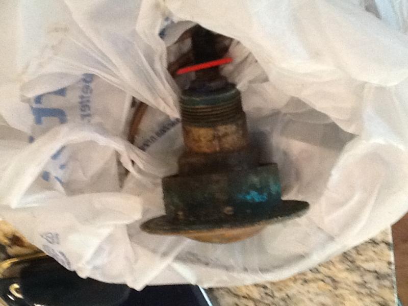

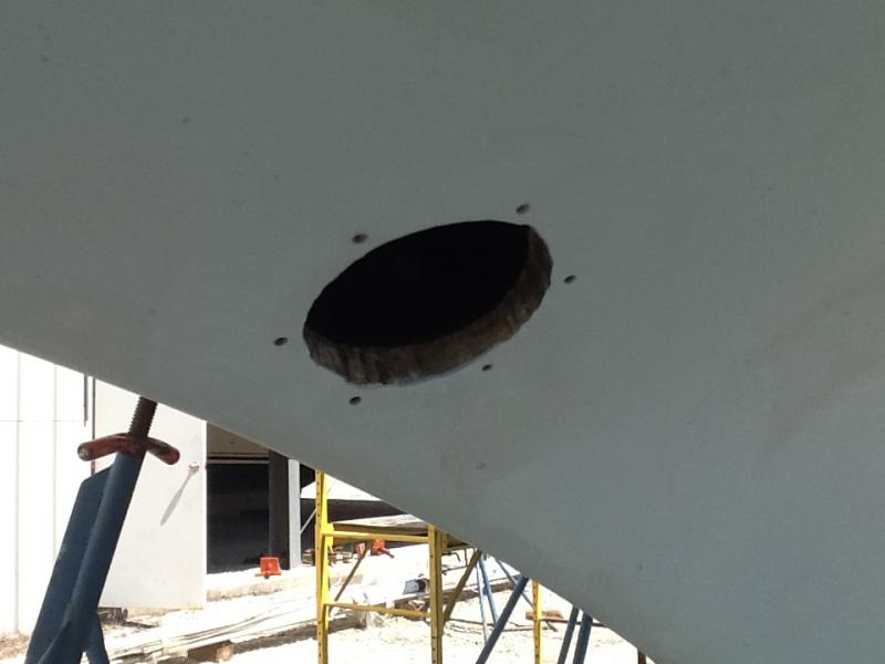

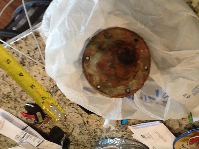

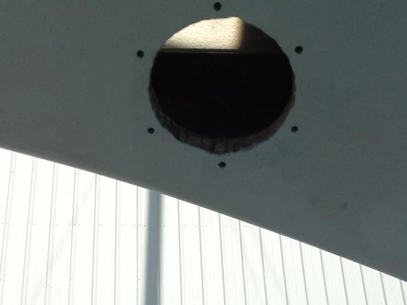

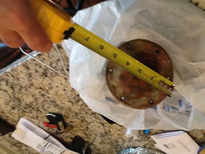

We are going with Raymarine ST60 series depth and speed gauges for replacements of what appear to be the original dinosaur era gauges. I spent a few hours, surgically removing the original depth transducer which appears to be about 10 pounds of pure brass. It leaves a 5 inch hole for us to contend with prior to installing the new transducer which only requires a 2 in hole
Our boat yard has a few ideas. I would like to know how you would handle this roadblock while maintaining original hull integrity. The pictures tell the story.

Wow that is an impressive hole for sure! If it were my boat I would glass it back in properly and then just redrill for the new ducer. It also looks to be at quite an angle, you may need a fairing block or mount it in a flatter section. Being a few feet farther aft will not matter as with the forward movement of the boat it will not matter that much.

I'm with Wayne. I don't see HOW the transducer could work at that angle. It could tell you how far away the lee shore is..

Usually I'd grind/feather it back to a 12:1 determined by 1/2 the thickness of the hull for these heavily built boats, lay in increasing circles of glass/epoxy but you don't have the space for this on the lower/forward portion.
Might rabbet the edge of the hole, something like 3/4" wide, half the depth then lay up a glass/epoxy plug (stepped to match the rabbet) which would be epoxied in place, faired and barrier coated.
I would, like the other responders, find another place to mount the transducer. I like the 'ducer as far forward as possible but it doen't really make that much difference. Mounting it level with the boat and keeping it in the water is more important.

I would restore the hull with new glass and resin. I would work from both sides. The long tapers are not etched in granite and are just the ideal. Stopping the grinding at the turn of the hull and extending along the turn of the bow would allow for laying in a strong repair. As far as the location of the sonar transducer. I always point my flashlight in the direction that I wish to see.

If money is a consideration, reinstall the transducer to plug the hole. Put the new transducer in a better spot so that it points down instead of to the side
