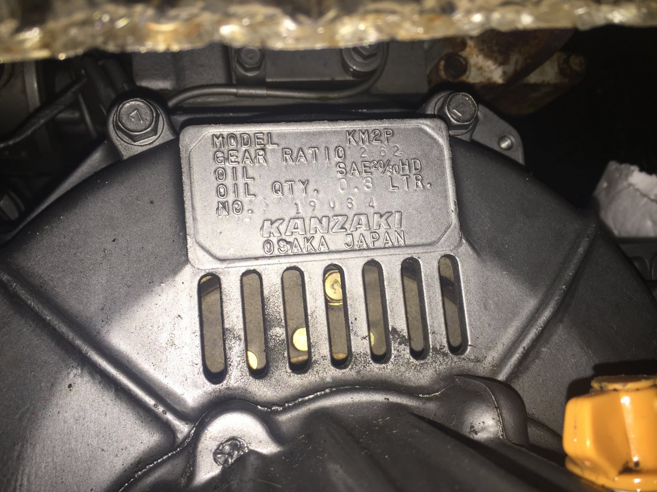

The bell housing on our boat has a plate that states ATF for our Kanzaki, so that is what I use.
Feb 6, 1998
11,709
Yanmar uses two gear boxes one built by Hurth with a round Kanzaki/Hurth emblem and one made by Kanzaki with a Kanzaki emblem. The Hurth made "Kanzaki" gear usesATF the Kanzaki uses 30 weight...
Hurth built Kanzaki's often have "BW" in the model as in KBW. The regular Hurth would be an HBW..
The OP's Universal diesel with a Hurth gear uses ATF III...
