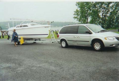

240 trailer mininan
Have had the 240 for two seasons and tow with a Chrysler minivan 6 cyl. My experience. Sit on 55-60 mph, have enough stuff in it for a week away, handles fine but I don't like to get over 60-65 mpg (who does) so keep a check on it going down long hills. Brakes well but always give plenty of braking distance. Have been on all sorts of ramps, wellsfleet very steep but good condition, have needed to use the extension other times, never had trouble (shouldn't say that to loud). If a ramp is very sandy and steep I probably would not even try it. I love it, pull up to a ramp and have to give a chuckle as everyone has 4x4s, monster trucks, diesels stinking everywhere etc, and we back down and launch in the same car we use all year round. Tow it 3 hrs to RI, 4.5 hrs to cape cod, twice a year. The long hill up past Lee on I90 is the only time i drop down, it is a tough hill. Ever other week 1hr to lake George, and go 4hr, 1000 islands once a year. you get the idea. The van is rated for it and does it, but boy does it sucks the gas :( But a hell of a lot cheaper than getting a dedicated another vehicle.
