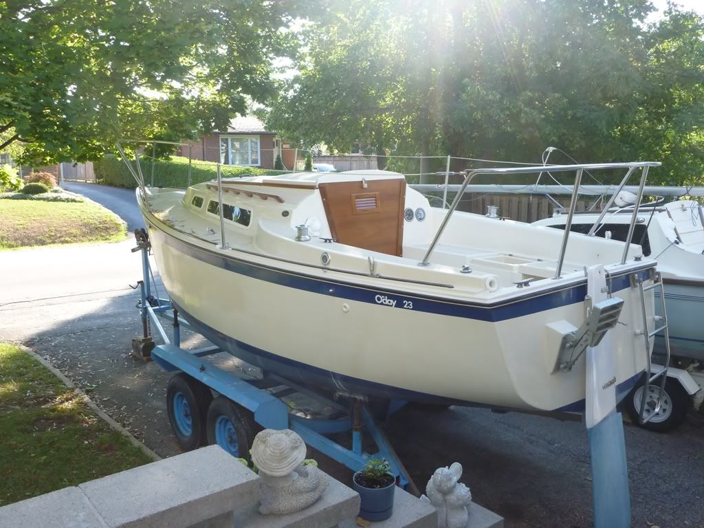

81 O'Day 23-2.......... Kiwi Magic Oakville, Ontario, Canada
Here are two pics of my trailer, I hope this helps you?
It is easy to get underneath for work on the hull.
I got this boat and trailer this summer, since then I have made bigger pads and fitted new tires.
Cheers
John

I got pads on mine. It is dead simple to get at the bottom of the boat to work on it. If you get brakes get the surge ones.

I agree with you DJ, surge brakes are the best, mine are electric and they work well too.
My trailer also has a sliding out hitch that works very well, just pull the pin out, insert it into the rear hole in the hitch bar, block the wheels and drive forward to extend the trailer length about 6 feet (a guess).
