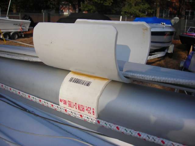

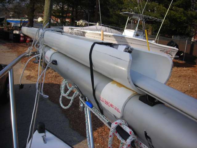

When I brought Bossa Nova home, I had to bend the CDI furler into an "S" curve. It was a nuisance to handle, and more nuisance when I put up the mast - flopping all over the place. :doh:
I may have crossed the line between "inventive" and "crazy", but I built a furler-support tray from a split piece of 4-inch PVC pipe - with a couple of "snap-ons" made of 3" pipe, to hold it in place. I split the pipes so they were a little more than half-round, so they would actually "snap on" and hold to the mast - which is just exactly 3" diameter on the 26X.
The tray is a bit less than 7 feet long, to reach from just under my whisker-pole ring to the upper flange of the reel. (That reel is bigger than 4" diameter, so it doesn't fit in the tray; but it's well-supported from above.) It's big enough that I'll be able to lay the furled sail into the tray. (Photo 1)
The snap-ons are bolted on with countersunk flat screws against the mast, and acorn nuts inside the tray - then glued with G-Flex epoxy, because it's what I had handy and I felt too cheap to buy PVC cement. (Photo 2)
I also built a couple of small brackets to hold the luff in place along the mast. (Photo 3)
This still needs to be bungied to the mast, but it will keep the end of the furler from drooping and bouncing as you go down the road. I can snap it onto the mast when I lower it, before I take the base off the tabernacle, and it keeps the furler "tamed" while I drag the mast-butt up to the bow pulpit brackets. It sticks out about 3 feet in front of the pulpit, but that hasn't been a problem with opening the back hatch of my 4Runner. :D

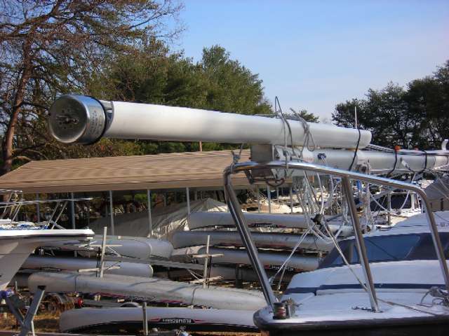

I have the CDI furler, 150% genoa and a canvas cover for it. I have the Mac mast raising set up and can't imagine raising the mast without it. As is , I routinely raise & lower mast solo. The P.O. stored the furler in a manner similar to Hoodge3000, if I am understanding him correctly. Without disconnecting the forestay and furler, this method made for a hard bend in the furler luff. I sailed my boat the first season with a break in the luff near the top. In the off season I fashioned a splint out of aluminum plate, pop rivets, and 3M 5200. Next season I trailered with furler bungied to the mast, with no support for the overhanging 2 feet or so of furler and drum. By the end of the season, I had broken the luff extrusion again down there. The new extrusion cost over $200. I now support the overhang in a manner similar to Beija Flor. I use an 8' section of pvc rain gutter cut in half and doubled up to make a 4' support. After seeing Beija Flor's set up, I am going to add those mast clips to the bottom of the gutter - Great Idea!
As to raising the mast, I have been experimenting with 2 methods. The first I got off this site, probably from Valentina, allowing the furler to hang over the side while raising the mast with the gin pole set up. Sometimes it will snag on the lifelines, but it is a simple matter to tie off the mast raising system and unsnag it as needed. The other way is to run the furling line from the drum through the bow fairlead, and back to the cock pit. Then as you raise the mast you can also pull the furler forward. This worked particularly well when partially dropping the mast to clear a low bridge in an area that we sail often.
I never take the foresail off of the furler, except of course when I am repairing or replaceing the luff extrusion!:doh:

My setup sounds like it's just like Blakes. I have a CDI on my 26S, I always leave it on, and I keep a sunbrella cover on it. I use my mast raising system with the baby stays in place, and raise and lower it by myself. Like Blake said, I use the furler line to pull the drum forward as I raise the mast.
I also use the vinyl rain gutter method, to support the overhang while trailering. I put the rain gutter over the top, to keep moisture from settling in it.

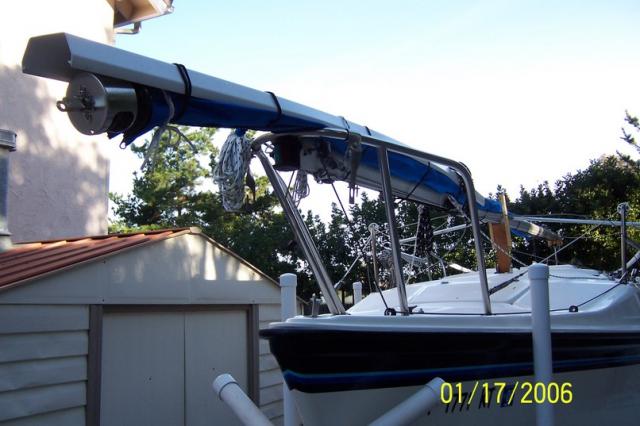

Let me try to decribe it. Once the mast is secured for trailering, the headsail furled and laying on the mast. I use three heavy bungee cords. One pulls the lower shrouds forward and is hooked to something on the mast, such as the reefing hook. A second is used in the same fashion for the upper shrouds, and the third is used for the backstay. There are no coils. I use about eight ball bungies to secure everything to the mast. I then wrap the sheets over the mast to help hold everything together. Everything is up off the deck, there's nothing to flop around.
When I'm ready to launch, I just undo all the bungies, and raise the mast.
I'd like to hear about other techniques used.
Here's a pic. It's hard to see the bungies, but I think you can see that there are no coils, nothing hanging, and the deck is clear.
