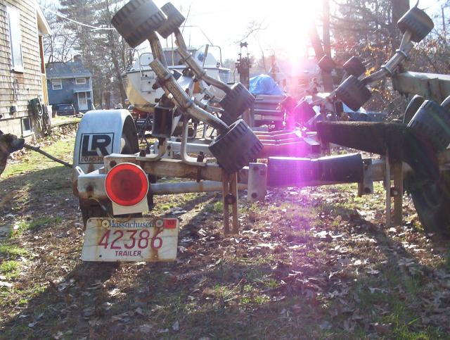

I'm going to be pulling my 84 O'day 222 out of the water for the first with the it's original trailer. How much water is needed? It's a Loadrite roller trailer.Any other tips would be a help.
If all your rollers are turning smooth and easy, you could back right down till the water is up the trailer's wheel hubs or a little deeper if you like. The best way to load your boat is to tie a 50' line on the bow cleat, and tie your regular stern line on the stern cleat and walk along the dock with the two lines keeping the boat out so that it floats directly toward the center of the trailer. If there is a dock on each side of the ramp, use the windward dock. The wind will keep your boat out and you can control the direction of the boat easier with your lines. Once the boat's bow is into the back of the trailer, the back rollers will hold it in position as long as you can hold the tension of the bow line while you work your way to your winch stanchion. The stern line can be thrown in the boat, or have someone hold it, but it isn't really necessary. Hold the tension on the bow line and take a large bite of the line and bring it around the winch stanchion twice, and tie two half hitches in the line. The boat can be held in place by the line and you can take your time and insert the winch cable hook into the bow eye by holding on to the rope and using it to steady yourself as you walk along the trailer frame. You don't even have to remove your shoes to do this. Remember to put a chalk under the front wheel of your towing vehicle after backing down the ramp, and remove it when you pull the boat out. When you go to launch this boat next year it would be a good idea to install a 12'' roller and bracket on the back trailer cross member so that the bow never comes in contact with it when you're unloading your boat from the trailer. My bow got damaged from hitting that last cross member years ago and after I installed the roller and bracket, I never had a problem after that. To launch this boat, back down the ramp as far as the trailer hubs, tie the 50' line on your bow cleat, release the winch hook from the bow eye, and give the bow a push and she should roll right off that trailer right down to the end of the dock. Have fun!
