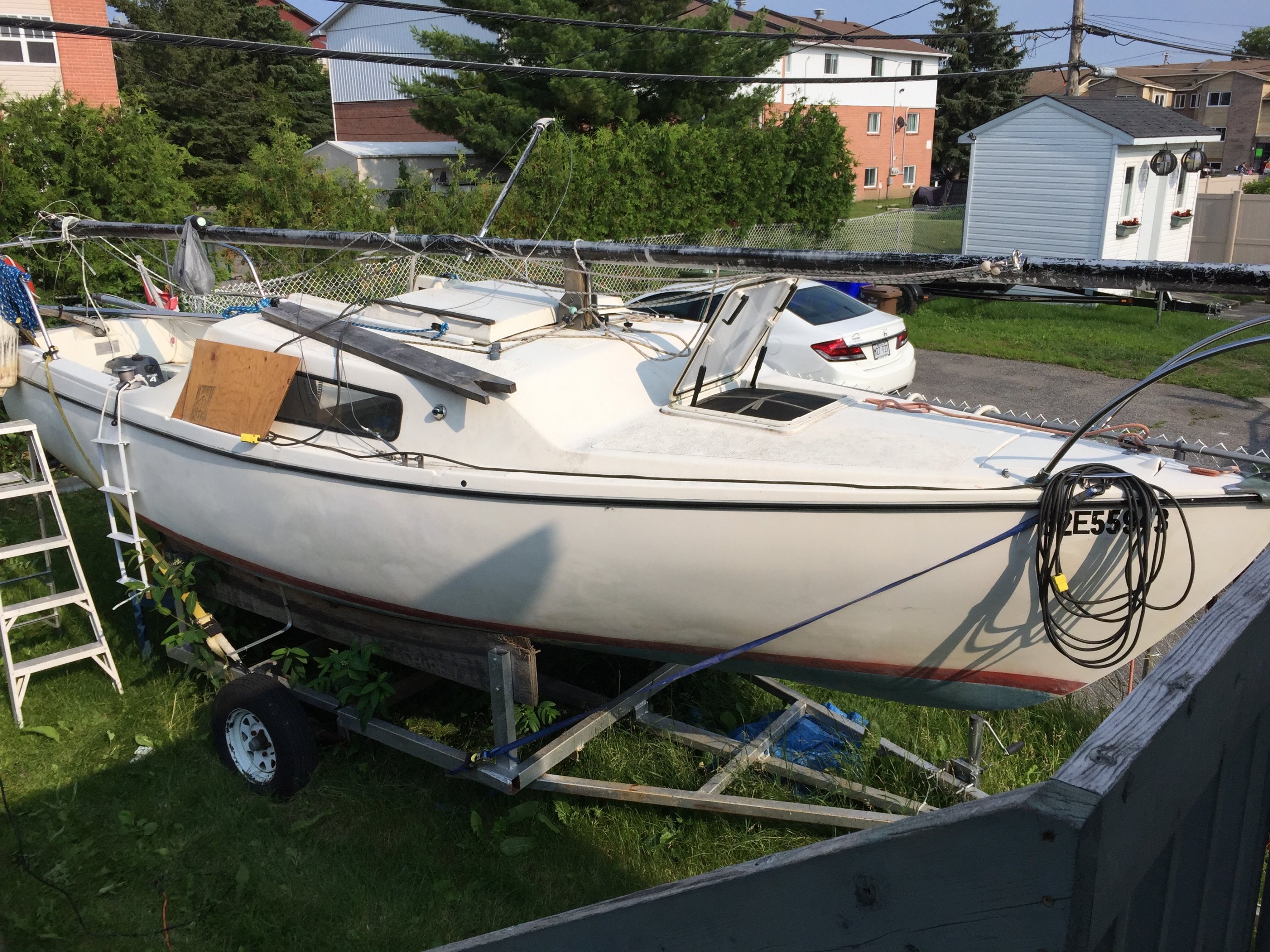

hey everyone, I just got the front end of my trailer modified, got an extension on the hitch, but I've just got the boat out of the water today and it's a royal pain in the %$#
any ideas on modifications to make retrieval easier, at the moment I have 2 plywood bunks, one on either side about 7-8 ft long and a plate to support the keel, no goal posts yet, one stopper at the bow but no hook to tie the boat to the trailer

I have the swing keel model
I dont know how to put pictures on this site

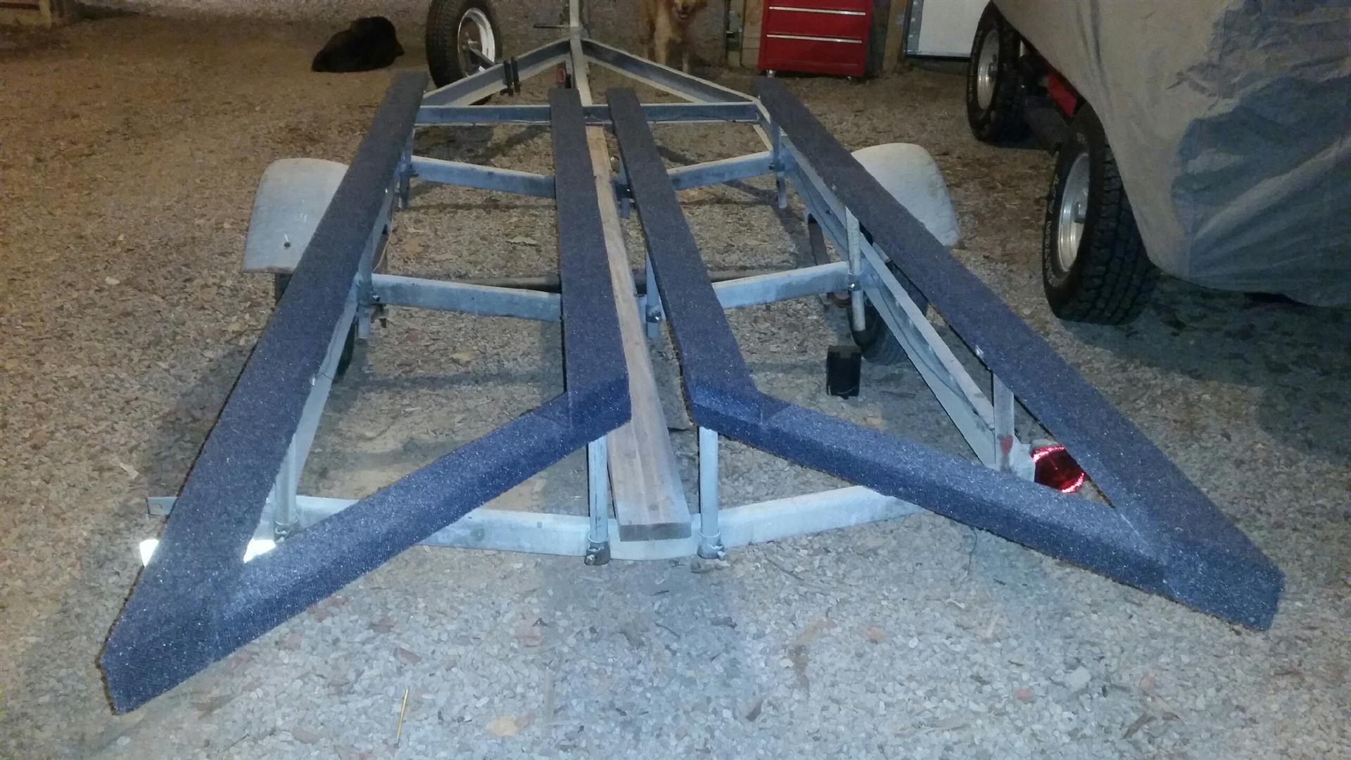

I re did our bunk boards on our trailer with new pressure treated 2x4 as that is what it was set up for. I made a long v front the inner boards to the outer boards to help guide the keel into the slot if you are just a bit off when you hit the trailer. This is what our trailer set up looks like.
The technique we have found works the best at our ramps, where we can't walk it in, is for me to back the trailer down and walk out on the trailer with the winch line out to the front of the bunk boards. Cindy drives the boat at a slow speed onto the trailer. She has gotten very good at hitting the keel slot and very seldom requires much correction from me to line her up. Once I can reach the bow eye on the boat I hook the boat with the winch line and winch her on the rest of the way. If it takes us longer than 2 minutes from start to finish it is because someone got in Cindy's way and she had to maneuver around them on her way into the trailer.
Knowing how far to back the trailer down into the water takes some trail and error. I like to just bury our trailer fenders. That still leaves enough of the keel slot for Cindy to sight on and yet enough exposed boards to act as a break and bring the boat to a stop.
The long v leading into the keel slot has really helped, you just want to be careful not to back it too far down into the water and have the v submerged below the keel, if that happens then the v is useless and it is easy to get the keel off to one side and out of the slot. the boat list about 10 degrees when that happens and we really have to back the trailer way down in the lake to get the boat to float up and over the bunk boards to fix that. It only happened once and that was before I added the long V. Don't want it to happen again.

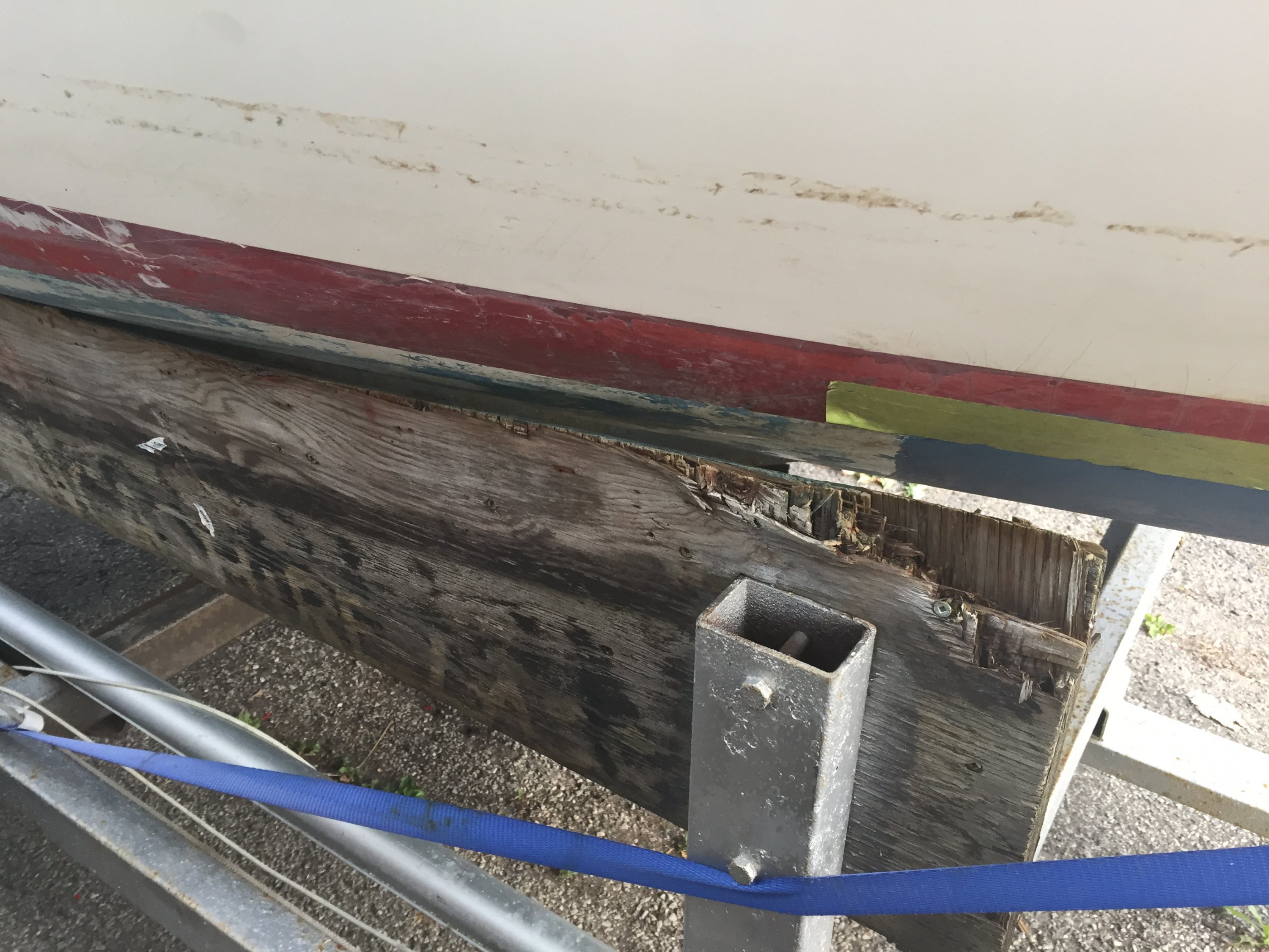

I don't mean to put your trailer down Fred but several laws of physics and proven engineering principles were totally ignored by who ever made that trailer.
Looks like the boat is probably sitting on the keel and the boards are just holding the boat level. I had a bad experience with that as our keel had rubbed a hole in the keel trunk causing a leak. Our boat was not designed to sit on the keel and I doubt yours was either.
Our boat now sits on the bunk boards and the keel gets lowered to the keel board so it is not in contact with the keel trunk going down the road. I just crank it back up prior to launch.

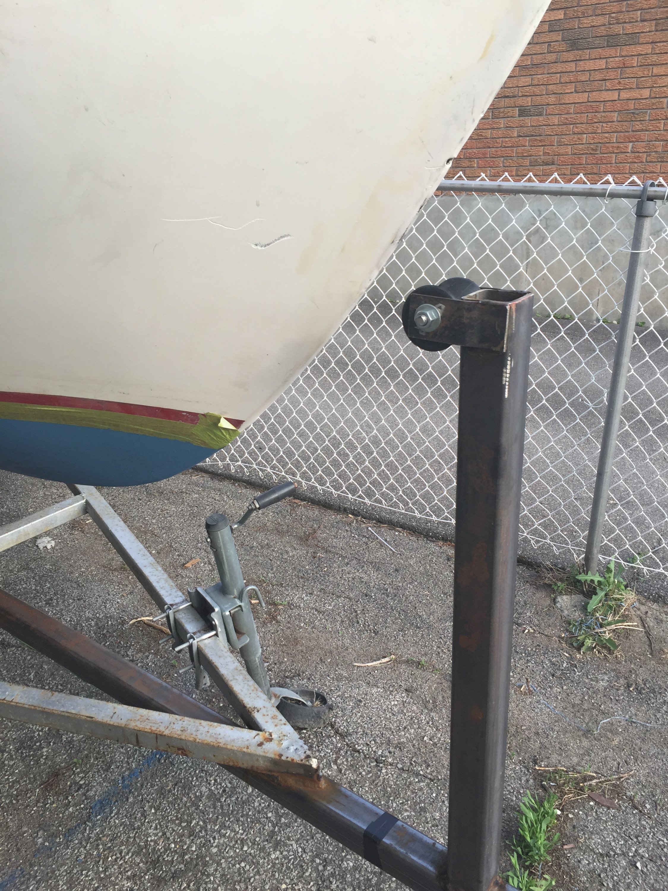

First as already mentioned adding a winch but you also need a bow eye to hook the winch to. I don't see one in the photo's hopefully there is one. Here is a photo of my winch stand which is a similar style boat shoal keel centerboard.

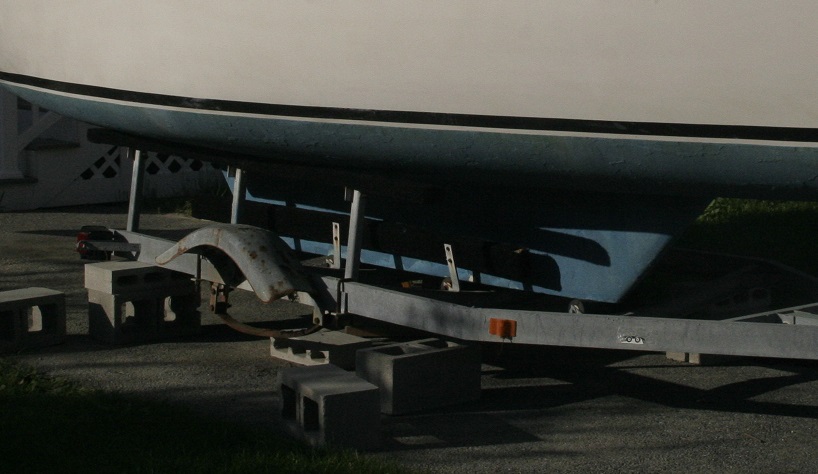

The second is the bunks, most bunks are 2X4's with the boat resting on the wide side to help distribute the load. They should be carpeted or covered with bunk material. In general the bunks are made to keep the boat balanced.Most of the weight is on the keel. Not a great photo but the best I have
I would work on these things first. Another thing would be keel rollers but I don't know if your trailer would accommodate them.
