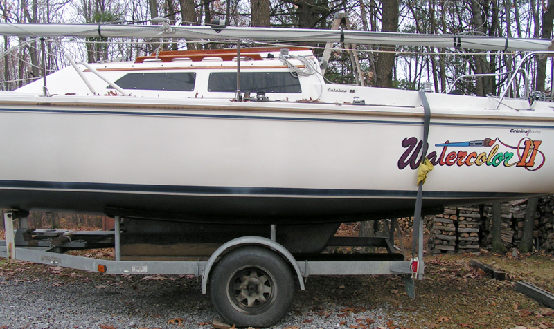

On the single axle swing keel trailers, it always appeared to me that the center of the axle is just to the aft of the center of the back window. Not very scientific but close enough for a good starting point for you.

Closer to 10 percent.
Having a 1987 model like yours and not knowing the total weight of boat, gear and trailer using a 3500 lb starting point I come up with 175 lbs at 5 percent and 245 lbs at 7 percent.
In real life, I changed tow vehicles a couple years ago and because the new vehicle was a conversion van I didn’t want to back it as deep into the water as the former pickup. I extended the tongue 18 inches without moving the boat or it’s location over the single axle trailer. Using a bathroom scale the tongue weight changed from 311 lbs. to 282 lbs. and the unit didn’t tow as well.
What 30 lbs of unweighting of the tongue didn’t cause the trailer to sway but, put a bounce into a 6200 lb vehicle with fairly new shocks. Moving the axle back 1.5 inches restored the original tongue weight and made life livable again.
I believe closer to 10 percent would work much better.
Now, for your rocking situation, as you say your boat may not be balanced on the bunks or the bunk supports may be weak. I think the universal laws on overhang beyond the taillights maybe 4 feet without attaching a flag.
My unit has worked very well over the last 20 years, photo attached, pictures are worth 1000 words.

Well, I must be OK. My axle is positioned about the same as "Watercolors," relative to the rear window; and my boat's sticking out about the same amount to the rear. The difference is in the overall length of the trailer, mine is longer out the front. The rocking I reported earlier seems to actually be the trailer frame flexing! If it hadn't been towing this boat for 26 years I'd be worried. I think adding a bow roller to support the front would be a good idea, I don't have one now.
