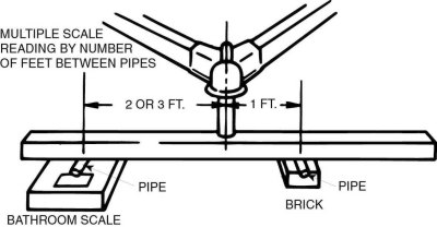

The tongue weight for boats should be 8-10 percent of the weight of the total load (some sources say higher wt is desired but I've found 10 percent is a good compromise unless experience indicates more weight is needed)
Too much weight on the hitch essentially lifts the vehicle’s front end, which in turn causes the front tires to lose grip on the road surface and makes steering difficult. In a situation where the tongue weight is too light the trailer will sway side-to-side at all but the slowest speeds.
You should weigh the entire rig to insure that the vehicle is up to the job. You can get the tongue wt at the same time you weigh the total package.
There is more about towing and weighing your vehicle at this link: http://h260.com/travel/travel.html
Tongue wt can be determined using a bathroom scale but that won't really help to know that unless you know the total wt of the boat and trailer together. This link provides instruction on this method.
http://www.handymanclub.com/projects/project.aspx?id=30066
There is similar method described on the Boat US website at: http://www.boatus.com/trailerclub/upkeep/backyard.asp

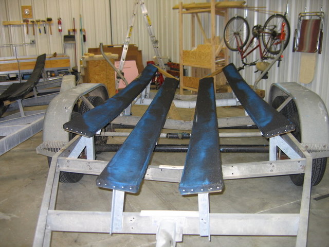

Hi George,
Thanks for your help in the photo it looks like your hunter 260 has double bunks on each side. Am I correct hard to see in the photo. Thats what I have been thinking for mine. I think it will distribute the weight more evenly less chance of cracking the hull if you hit a good bump. Whats your opinion. I have a single axle trailer has quite a bit of flex in it lengthwise is that normal ?
