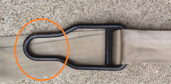

Hello Sailor Gurus,
I have a trailer tie down strap that seems to be simple, but I can't seem to keep the simple thing to stay tight. I feel stupid to be outwitted by a strap!!! Help Please and Thank You.
12,553
I have something similar on my hobie trailer
There should be a metal slip ring that goes over the part I circled in red
Imagine you flipped the black metal part (clasp) to the right... and then snug up the strap.. then when you flipped the clasp back the other way, it would add just a little more tension... then a metal ring slips down over the part I have circled on the clasp to hold the clasp in the tensed position.

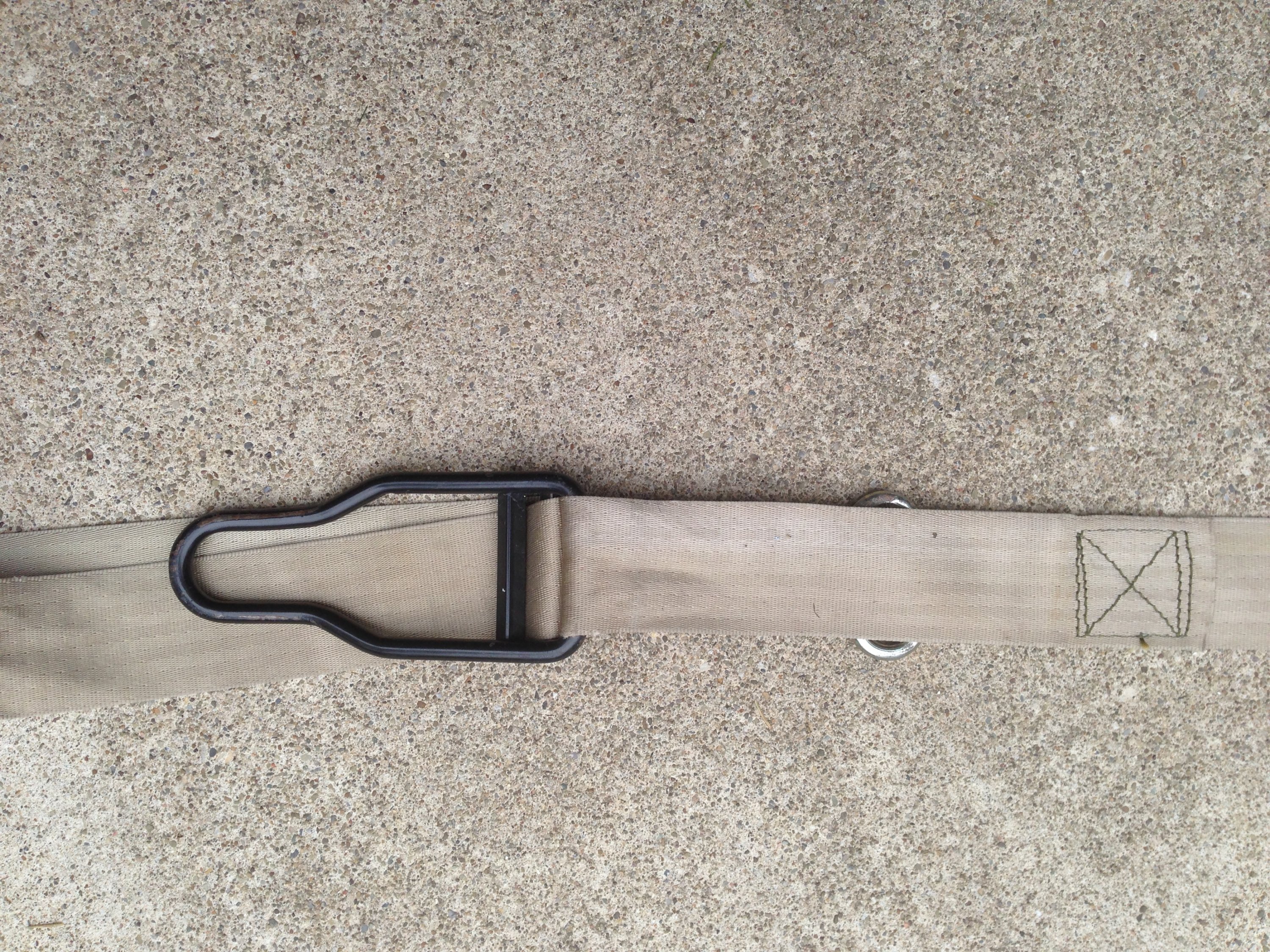

Yes there is a metal ring on the back side of the strap, I pull the strap tight, flip and twist the bracket over ,slide the ring over it then I have to tie a knot with the loose end of the strap over the bracket. iIt still doesn't seem to be tight enough
12,553
yeah! I feel your pain... I gave up on mine to and went with some of these.... Be careful not to over tighten these.

I strongly suspect that the strap was somehow threaded wrong before you received it. If you pull the two straps apart totally, and re-thread the pickup line in the other side, I think it will start working.
