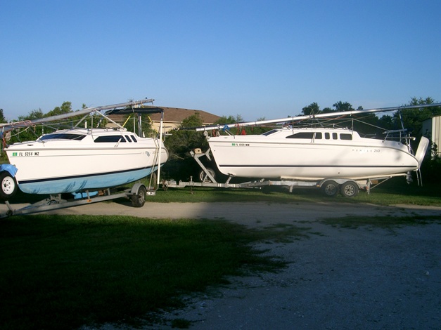

I towed our old 240 with a single axle trailer just like yours for 1000's of miles with a Suburban and as was mentioned you'll need to (#1)weight the tongue, (#2)check your tires and (#3) have a good tow vehicle. Tail weight and low tire pressure on radial tires will be a killer. Bonafide trailer tires properly inflated with stout sidewalls are a must, but may still fall short for your issue. If it's not a tow vehicle that's too small, load imbalance or tire issues then it's just too much boat for a single axle trailer.
All that said I've pulled much bigger trailers my entire life and couldn't fix how terrible our 240 and its single axle trailer towed at speeds over 55mph until I bought our 260 with a dual axle trailer. Our 260 and its trailer is 30% heavier but far easier to tow. So do what you can, be safe and don't get in a hurry.
We've trailered our 260 all over your neck of the woods and loved it up there. Here's a pic from Silver Glen on the St johns at lake George. Have a good season. Mike

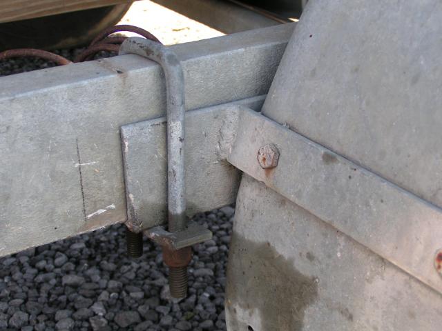

Check your trailer, after market trailers are built to handle many sizes of boats and what they do is the axles and springs are attached to a separate frame and then attached to the mainframe of the trailer. If you have this then just move the axle back, if you have boat mfg’s trailer then move the boat forward on the bunks. See photo of trailer with movable axles U-bolted to the main trailer frame.
