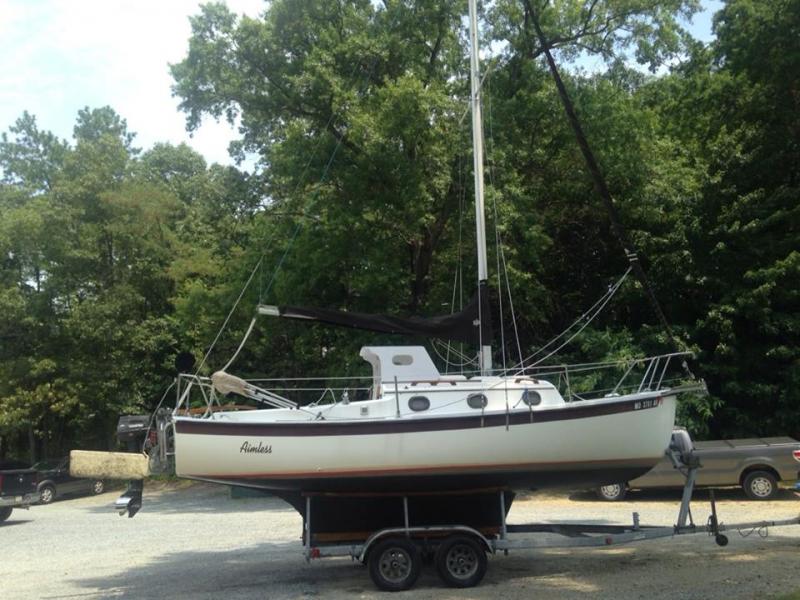

The brake job is done and the boat is now home. It was an uneventful tow. Funny, the first time I was every happy to see traffic because it kept things nice and easy. My tacoma did great for the tow.
Dropping the mast single handed without a system was a bear. I am not sure if I would want to do that again but I managed to do it without dropping or breaking anything.

Good lookin' boat.
If you plan on trailering often, stepping the mast is no big deal once you figure it out. Use a gin pole and some temp stays. Just takes a few minutes. You can see a bunch of videos on line.

I love the looks of this boat. She feels solid even though she is a smaller boat. It isn't as hefty as I am use to (Previous boat was a Catalina 30). She will definitely do.
either way she is home and slowly getting some refit work done. It is all minor stuff but I want to have her just right by next season. I am not sure if my season is done or if I will launch a few times. The ramps in my area may be an issue and I am going to be really dependent on a high tide.
