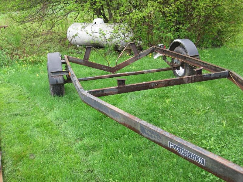

Hello, Once again I lean on the depth of the forum for information. I have the stock trailer for my V25. It is still in good shape and I want to keep it that way. I treated it with rust converter once and covered it with an industrial Rustolem primer. Well the "I'm going to finish with a top coat" never happened due to the fact that the urge to actually go sailing took over, two years ago.
At any rate I am looking at stripping it down the best I can, letting the light coat of rust form and then treat with Corroseal. Does anyone have a suggestion on a good top coat that will handle road wear and salt water immersion. Days can go by before it gets hit with a hose and rinsed off. Any input is appreciated. I did scour the forum and there is good information. just looking for some fresh input. Thanks.
