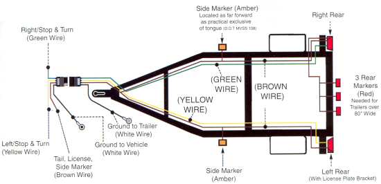

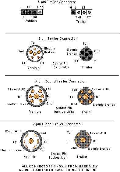

Your brake and turn lights are the same circuit and bulb filament. Check the wires at the connector. Sometimes the diagrams are confusing because they show you an inside out view and a mirror image. Check with your meter which is your brake and turn light connector they should be the same one. You will notice that the brown wires run down both sides of the frame, those are your tail lights. The green and yellow are your right and left turn signals. I doubt that it is your ground if your turn lights are working.
Here are some nice diagrams.
