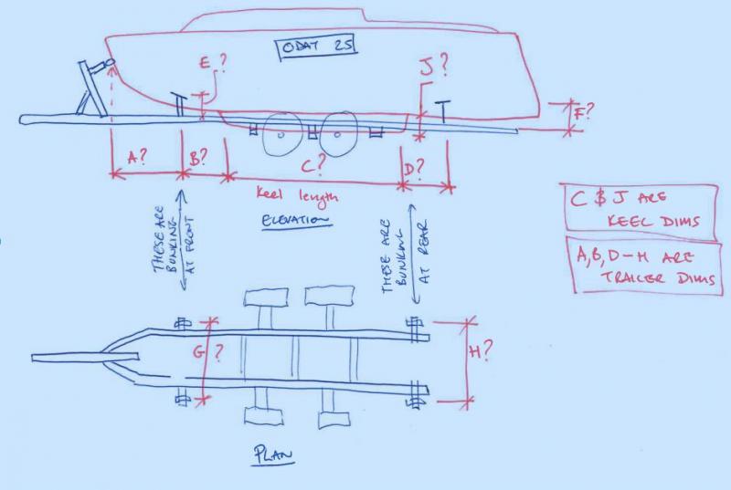

I recently took owner"ship" of an O'Day 25 and am looking to winterize and renovate it at home. I'm in the final throws of making the tandem axle trailer, but was wondering if anyone on the forum can provide some dimensions of their trailer and boat if its out of the water?
The dimensions are all on the attached sketches.
If anyone can help I would appreciate it. This may also be helpful for other owners looking to build a trailer.

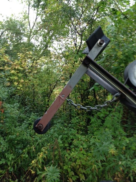

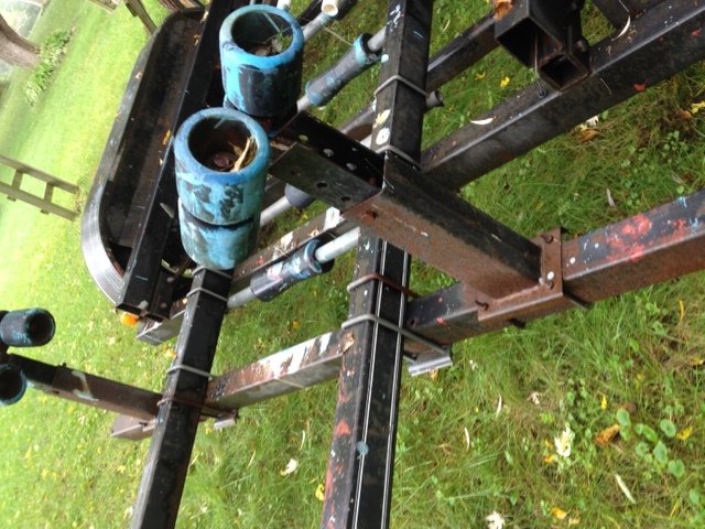

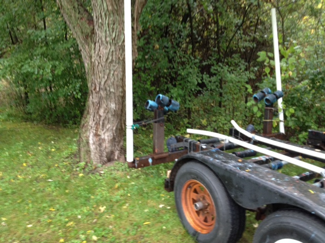

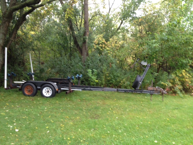

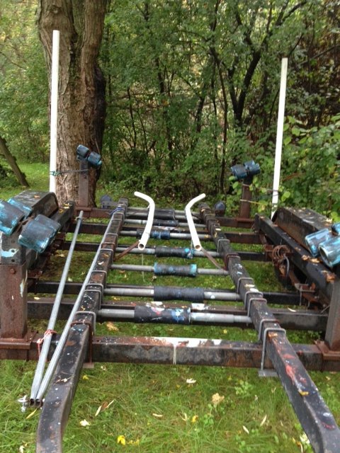

My boat (1983 O'Day 25) is still in the water but I did go take some photos of the trailer and I did some measurements for you. The length A is 110 inches and the length B+C+D is 110 inches. The width G from the center of the roller supports forward is 44 inches and the width of the H supports is 66 inches. I have trailer guides aft that are 96 inches wide. The height of the forward roller supports from the base to the mounting bracket for the rollers is 21.5 inches and it is 21.75 inches from the base of to the roller brackets for the aft supports. Note that these are mounted on a cross-tube that is mounted under the main tubing so you have to add 4 inches to each of these measurements. The height of the bow support from the main tube to the lower roller is 39 inches. Note that I had to lower that since for some launch ramps, the bow ring would catch on the lower roller and keep the boat from easily rolling off the boat. The length of the bar holding the two rollers on the bow stop is 20 inches. I've attached some photos to help illustrate. Let me know if you have any other questions. Note that now that I've added the trailer guides, I no longer needed the keel guides so I'm taking them off since they serve no purpose.
