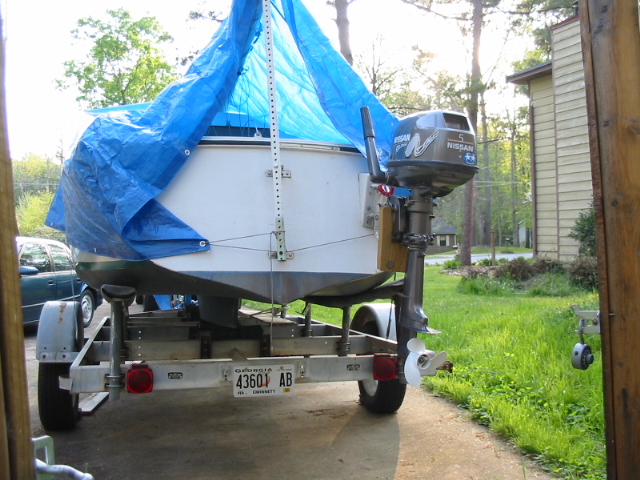

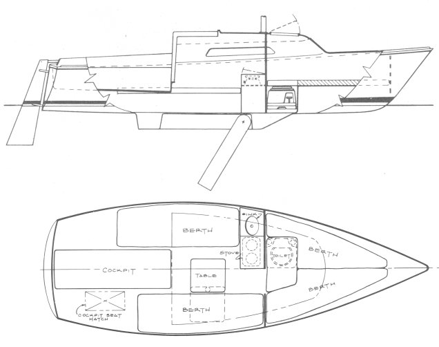

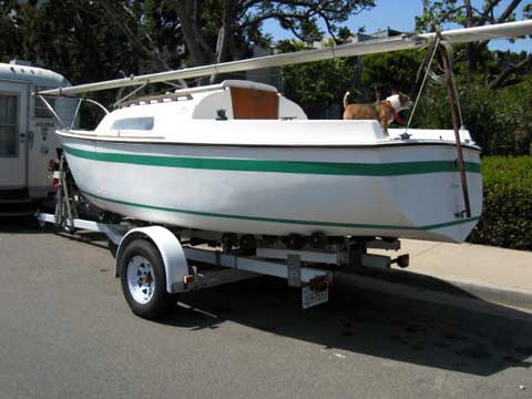

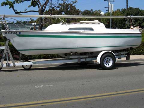

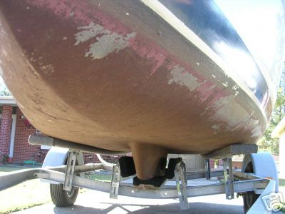

I'd guess that the keel sticks down about 6" or so below the bottom of the boat. Draft is 14" with the CB up, so I'm estimating that the keel is +/- half of that. I've attched pictures of various O'DAY 20s on trailers, plus a drawing from O'Day. Most trailers for powerboats around 20' should be easy to adapt to the 20. Just be sure that you have rollers or such support under the keel.
