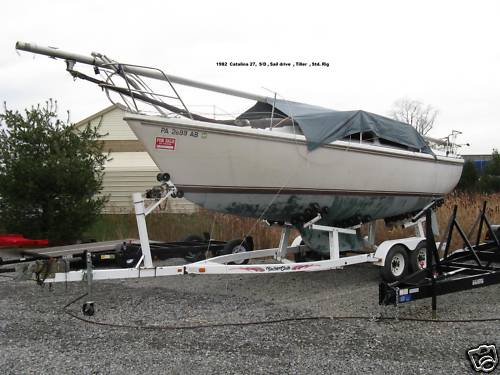

Where are you trailering from? I will be bringing mine from Butler, PA to Los Angeles this June. I bought if from a guy who is in the business of making trailers.
