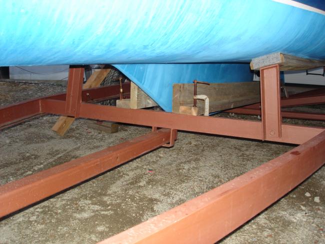

A while back I read a thread about trailer bunk guides for shoal draft keel boats. I always had a hard time centering my Oday 22 on my trailer until I "C" clamped home made keel guides on my trailer. The bonus from clamping the guides on comes from the ease of removing them to clean/ paint the keel. Just general info. Erik

What is the Keel resting on...and if it is resting on something, how much of it is resting on it? Most of the Shoal draft keeels need to be supported at the keel, generally most of the weight of the boat is supposed to be resting on the keel with the bunks just pretty much hold the boat from falling over. By the way, that looks nice. Jack
