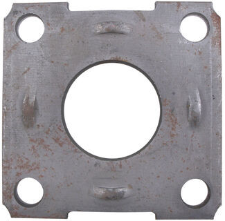

The spindle doesn't come off. You pull the hub and then make/get a bracket like this.....
...or one with a square hole in the middle depending on how far it has to go onto your axle. I measured the stock one today and it looks like it would end up about where the spindle is welded to the square tubing.
Also make sure you have the right spindles for the disc brake hubs. They have to be stepped as the ID of the two hub bearings are different. Pull your hub and if that is the case If so you will be good to go.
Then put the disc hub on and position the bracket the right distance behind it by putting the calipers on the rotor and mounting the bracket that comes with the kit to the calipers and now you will know where the axle bracket goes. If you have any concerns here then take the axle off and to a welder along with the new hubs and have him do it.
