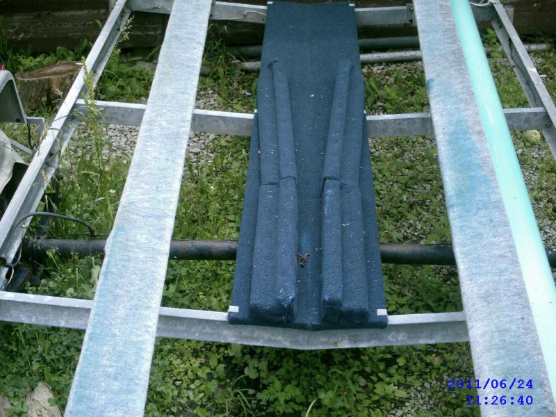

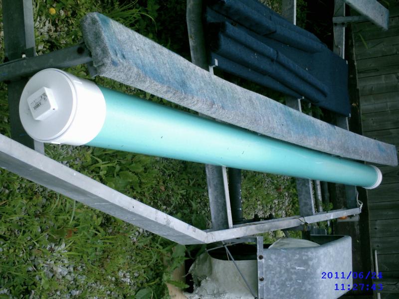

Om my 23.5 1995 8 ft long 12" wide.Added keel guides as per pix .Helps center boat putting on trailer.Also added 6 in pipe for boom,mast raising gin pole Save interior damage.

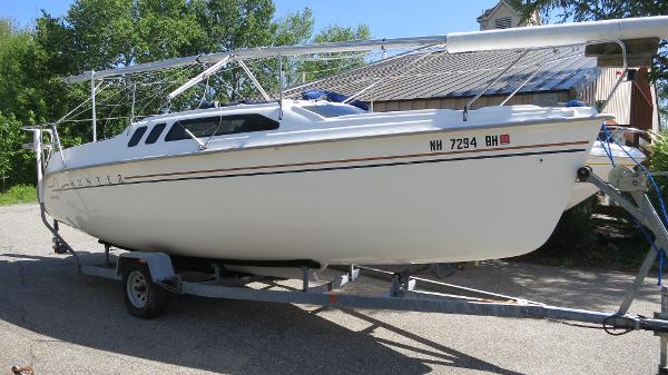

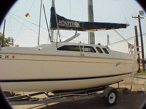

I've noticed there were 2 factory trailers for the 1998 240's- the older style may have been left over from the 23.5. The older style (like mine) has squared-off fenders, and the centerboard bunk is shorter. The front of the centerboard extends in front of the bunk by a couple of feet. This model has 4 vertical supports for the side bunks. The later style has round fenders, and a longer centerboard bunk that extends under the whole board. The newer trailer also has only 3 vertical supports for the side bunks. See attached photos-

Mine is like pictures 2 and 3 with the keel tray boards to the front brace. My biggest issue was when the boat would get a little crooked the swing keel would be to one side or the other of the 1*8's and not yet over the most forward trailer frame structure. With the boat weight it would really bow the board down until I got the bow snugged up against the winch post. The snugging process had actually peeled back part of the 1* while cranking the baot forward.
