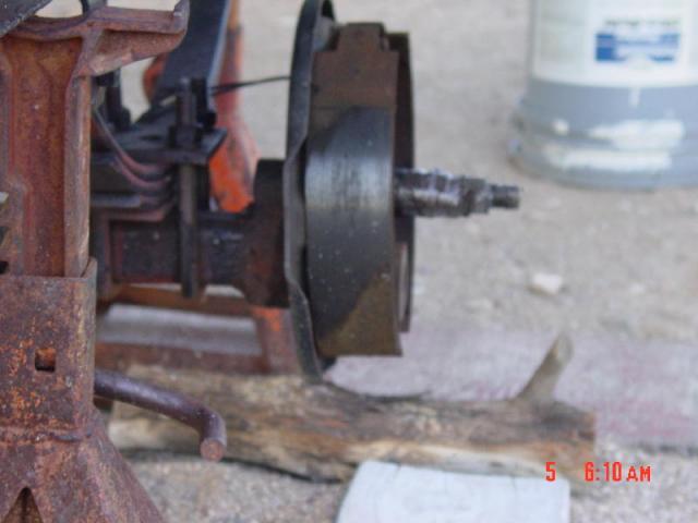

I've lived too long in ignorance. My trailer's left wheel is listing terribly to port. I suspect that the spindle is poorly mated to the axle, in whatever way it's to be mated. Have any of y'all dealt with a spindle that isn't quite square with the axle? Tom

All the trailer axle spindles I have ever seen are welded on. Are you sure it's the spindle and not bad bearings? If it is the spindle, then I suspect you will either need to have it re-welded on or get a replacement axle. Post a picture of it with the wheel removed so we can see what you are talking about :)

A photo would be nice. But first thing you could do is block your trailer up so its safe. With boat removed, then remove both wheels so you have a line of sight that you can judge the ends of your axle. Place a straight bar or a 2X4 along this axle(bar or 2X4 needs to be longer than the axle) if you can clamp it do that.
measure just inside the frame and note the measurement. You want to do this on both sides left and right. They should be the same. This will allow you to know your bar you are using is parallel to the axle. Then move to the outer most ends and check those. The reading should be the same on both sides. If so your axle is straight. My bet is that it is unless this wheel has hit something very hard. Plus you would see wear on your tires. If it is bent you my need to take it to a good welding shop for the repair. If you need detailed notes on replacing the spindle yourself let me know. I've made axles for boat trailers up to semi trucks. Its not to hard if you have the tools

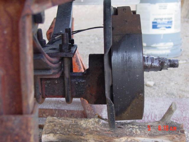

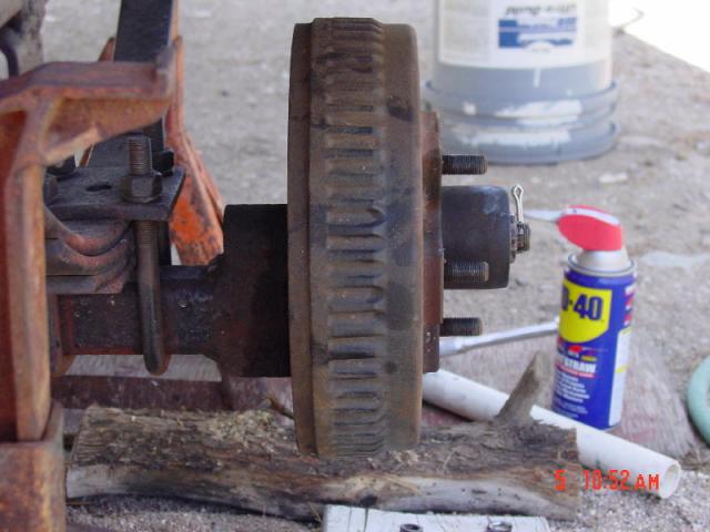

Thanks for your replies. Not the greatest photos, but these may give some idea. The hub and bearings rode smoothly. The brake backing plate looks more out-of-kilter than the spindle. I'll remove the backing plate today, and clean up the grease for a better look-see. More to come.

Removed the brake backing plate, and found that the spindle flange was interfering with the plate's ability to seat squarely. It looks like the spindle/axle is okay. Most likely an aftermarket brake plate. Strange how the wheel bearings felt good when the hub was so cockeyed.
