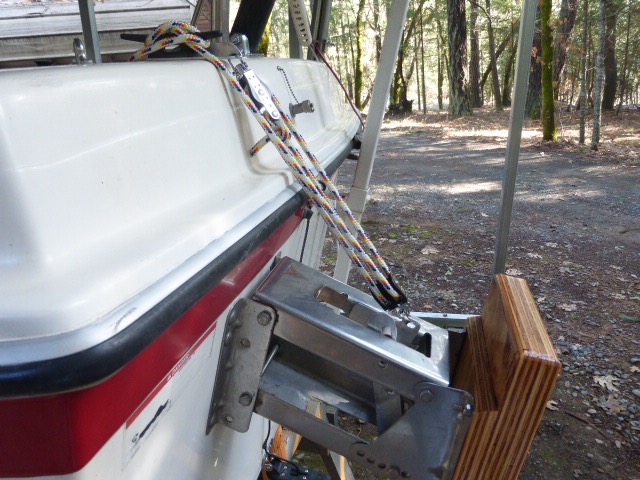

This was a great mod for us! even lifting our little 4 hp, without having to navigate under the rear rail and hang over the transom, is SO much easier now.
