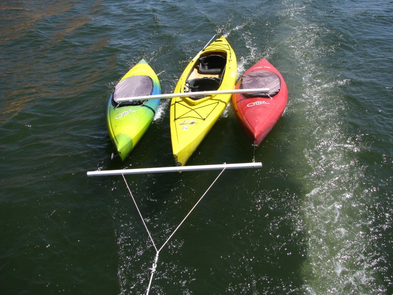

I towed the three kayaks in the picture many miles at Lake Powell. The year before I did not have the covers to keep the water out of the smaller ones and they would eventually fill up.. and I would have to stop and bail them out.

I used to tow ours on a rig similar to the photo above and it worked well.... until it didn't. We were running downwind in a 15-20 knot wind and seas building to 3 feet. 3 feet is large enough for the kayaks to surf down and when they did, they'd slip sideways and eventually, one rolled and became a pretty hefty sea anchor! It took a ton of work and a detour to tuck into the lee of an island to get the kayak upright. I would never have done that out on the open water of Lake Superior, but I figured inside the islands where we sail it would be alright. WRONG!
