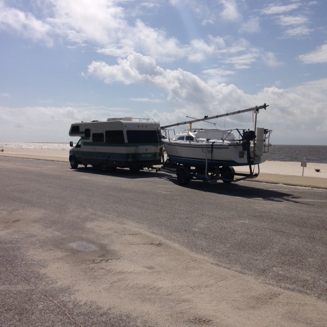

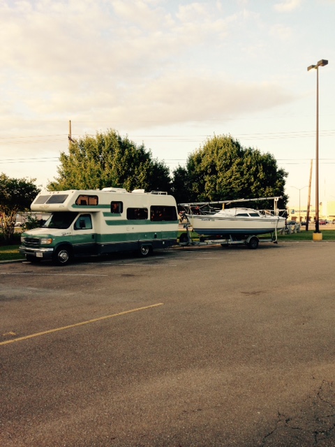

I retired earlier this year and we also have dreamed about traveling with our sailboat and exploring new destinations. Earlier this year we towed our C-22 behind our 24' motorhome from our home in San Diego to Florida. The motorhome was very comfortable to stay in while traveling. I was concerned about being able to back the motorhome up with a boat behind me at the launching ramp. I installed a receiver hitch on the front, and all we do is rig the boat, drive to the ramp, chock the trailer tires and disconnect it from the motorhome. Turn the motorhome around, and re-connect the trailer to the front hitch. I can now see clearly, and can maneuver the boat and trailer with precision.

Spending the night at a Wal-Mart parking lot as we make our way across the country.

Our arrival in Florida along the Gulf of Mexico.
