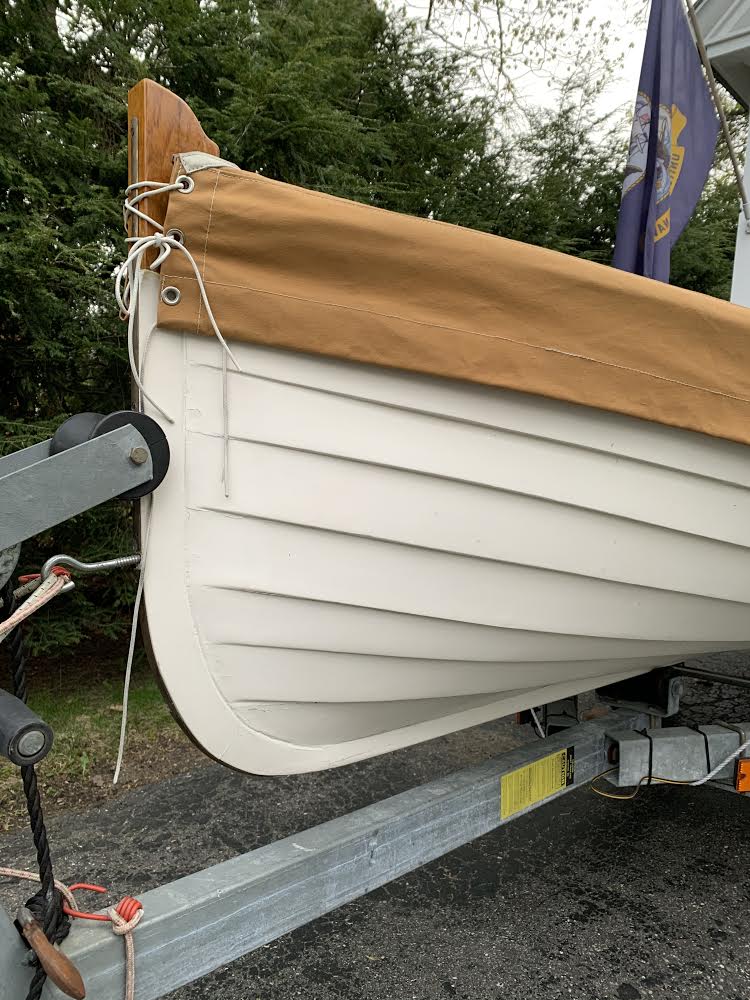

I have a new wooden dinghy. I am interested to know how you would attach a towing bridle to it. My previous inflatable had the bow ring and two D-rings for the bridle. As you can see from the picture, this dinghy only has an eyebolt right now. Although it probably has more longitudinal stability than the inflatable did, I suspect it would still be good to have a three point connection to minimize the yaw as she gets towed. Where would I attach the outboard connections?
I don’t intend to do anything other than coastal trips here in Maine. Welcome your advice.

She is a beauty! An eyebolt on the stem should suffice for towing. My brother in law tows a Dhow dinghy with his trawler, and it tracks nicely using only the eyebolt.
May 25, 2012
4,338
that is not an eye-bolt. is that a lag-style hook? is it through bolted?
you will slurp in 500lbs of water now and then, multiple points of reinforced through bolted eye bolts would be nice but self bailing is a must for me.
......... but that's me

Jon - that is a lag bolt in there right now from the previous owner, but it has a bronze through-bolt that should go there (I need to determine why It was taken out). Am I to read from your reply that I should be ok with just the single attachment?
Good point about the self-bailing. I don’t believe it does. Is that something I could install?

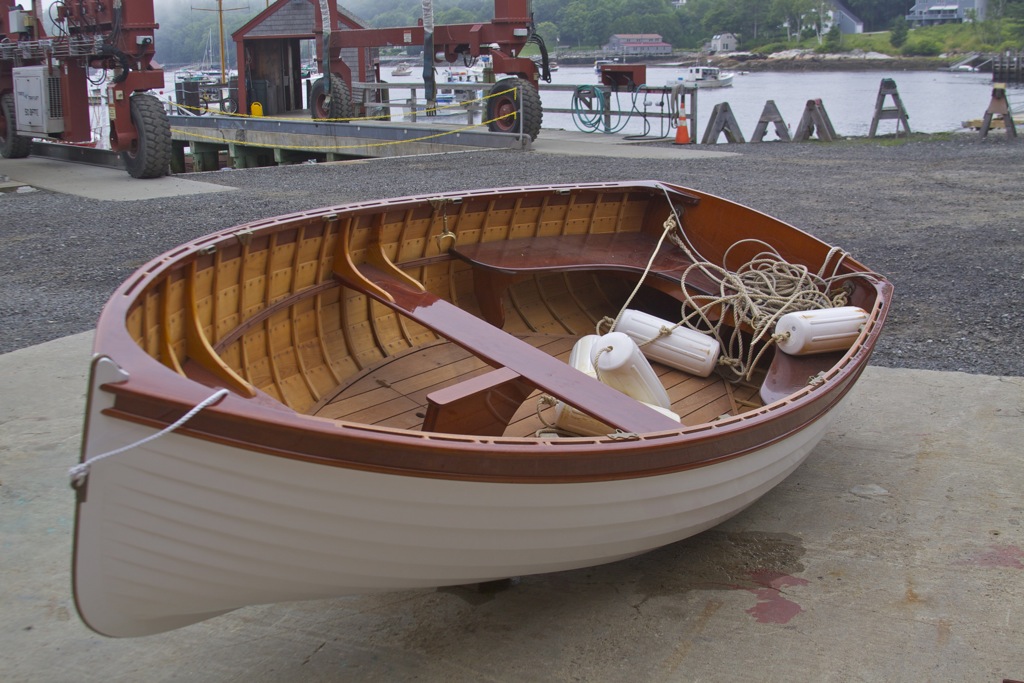

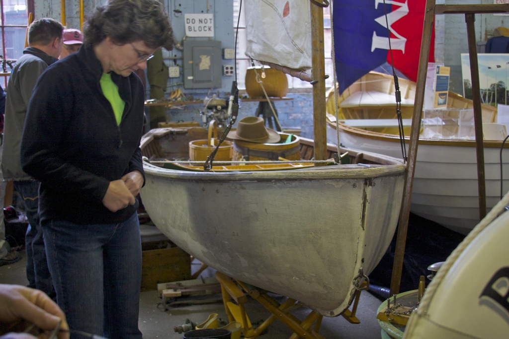

That temporary screw eye is about the right place for a proper towing attachment: low so the bow rides a little high.
It has to be through bolted with a good backing plate. Some tenders have use a an eye strap, 2 bolts, with a captive stout ring.
