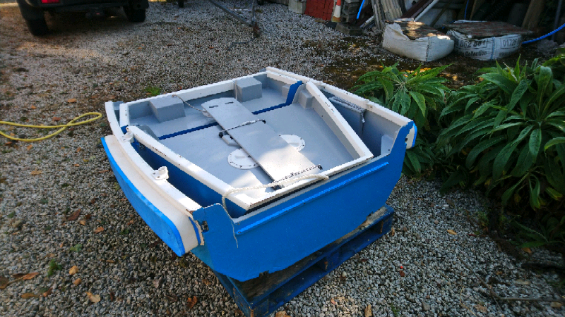

What about a nesting dinghy. It’s compact might fit in the 5 ft bow space.
Here is a video.
