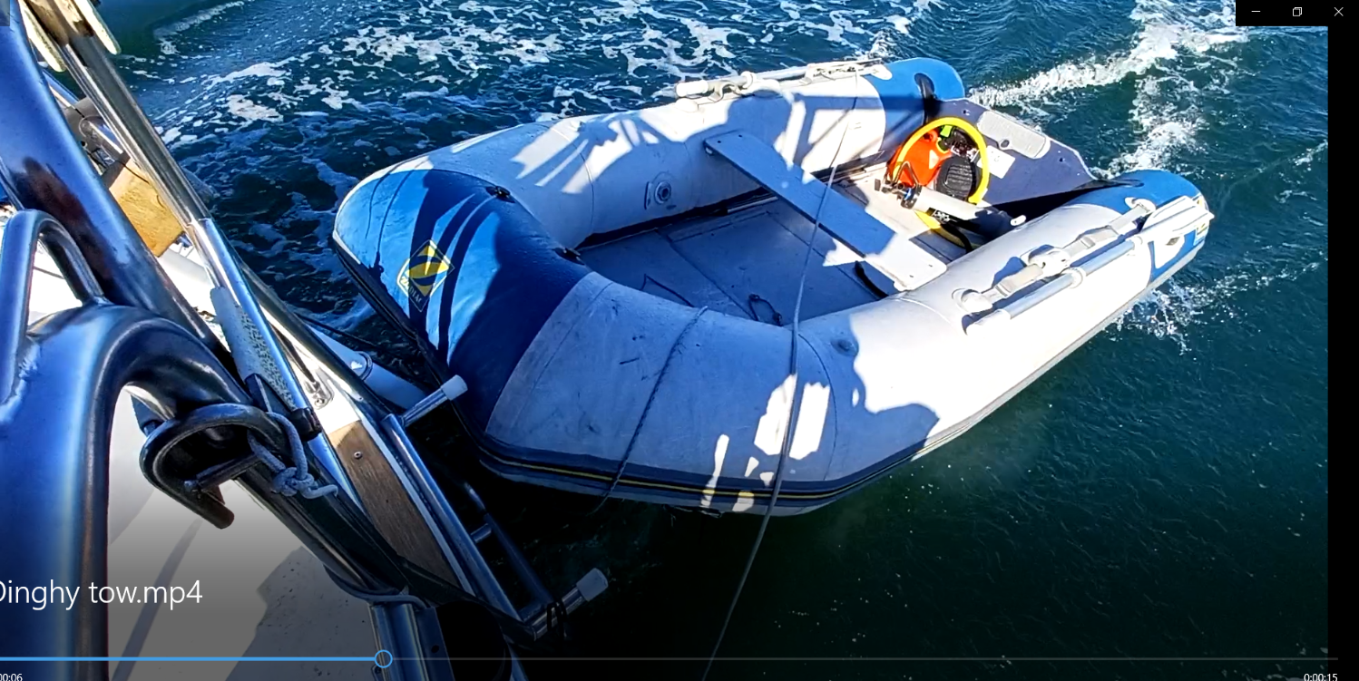

Been towing our small Mercury roll up with the outboard attached in the raised position for about ten years with no issues. Our roll up has two D rings and a short bridle and then a single tow line. When we approach the dock we have the bow of the dinghy right up to our stern on the outermost stern cleat so that we can reverse without getting the tow line wrapped around the prop. Tow line has floats also. In a tight docking situation we tie it to the outside mid ship cleat with a short lead allowing the dinghy just enough line to swing in either direction. As to slowing the boat, I believe it unfortunately provides a measurable reduction in speed when motoring or in light airs. Try pulling it in by hand while under way at hull speed and you will feel about a fifty pound drag. If someone is really curious about the effect of that drag on speed, please perform the following: Tow the dinghy and note the steady GPS speed. Toss the tow line overboard and note the change in GPS speed when it stabilizes. Record results. Report here for the rest of us. Of course, go back and retrieve your dinghy.

When I do tow my 9.5’ RIB the outboard is removed. I use two tow lines with separate attachment to the towing eye. If one parts, the other is still attached, etc. I use only floating tow lines of polypropylene or other cord material that floats. I use soft shackles, or with the end of the tow line passed through the towing eye of the dink then through an eye splice in the tow line to secure. If eye thimbles are used they are the plastic ones. The floating lines reduce the risk of fouling the prop or rudder from sucking them under. However, it’s still best to pull the dink close to the boat and get the lines mostly out of the water when backing or trying to maneuver the boat in close settings. As mentioned, you can lessened the towing drag some by riding the dink on a stern wave, or just inside the second one so it’s actually pushing the dink along, somewhat. I usually keep mine fairly close, however. Control slewing by adjusting the independent tow lines. I recommend not using the D-rings on the chambers as the towing “strong point”; use the eye on the bow of the dink. Remove the oars when towing, and anything else that might interfere with managing the dink in poor conditions, such as an outboard! If you must tow with outboard attached, don’t depend only on the mounting set screws to secure it. Use a safety lanyard to clip it to the dink as back up. Good luck with it!

Doing this 25-years ago when I first purchased by current boat was what prompted me to go to my system of lifting the nose of the boat out of the water and letting it skate on only the stern few inches of each tube. Papillon was my first boat with a dingy and I was trying to find the "perfect distance" to tow because I had read that the dink would pull easier if it "rode" the stern wave. By hand towing, I could gage the drag and found a distance that has some reduction in pulling force which supported the theory. Being the engineering/physics type I just had to test all possibilities. When I got the to point where the upward angle of the line lifted the bow of the inflatable out of the water the pull on my hand dropped to less than half what it was while farther back. For me, that settled that and I have been towing this way for 25-years in all weather with no mishaps.
I have a small horn cleat that is about 12" inboard of the corner of the transom that I drop the head of my bridle over and that gets me the perfect position every time.
