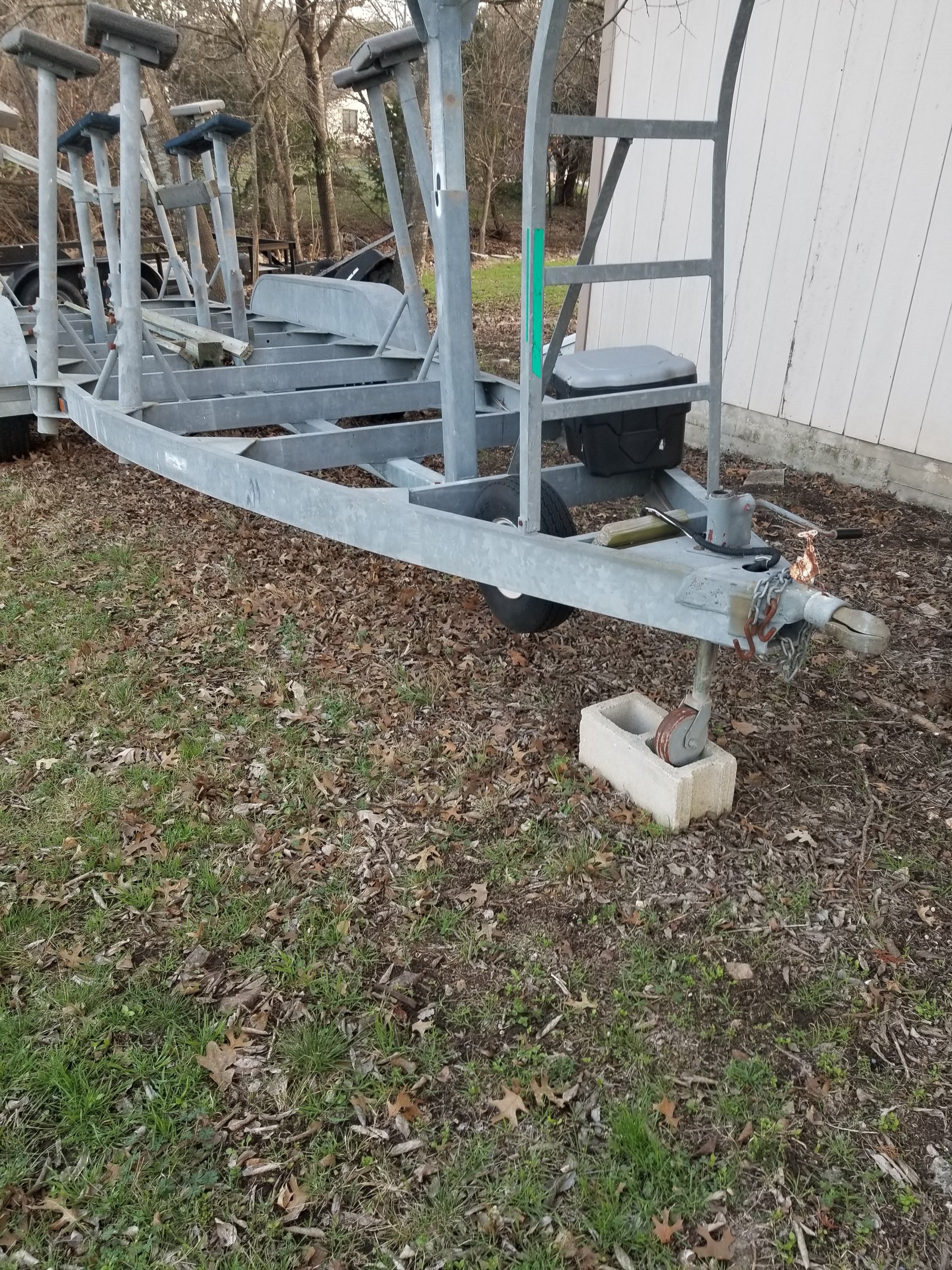

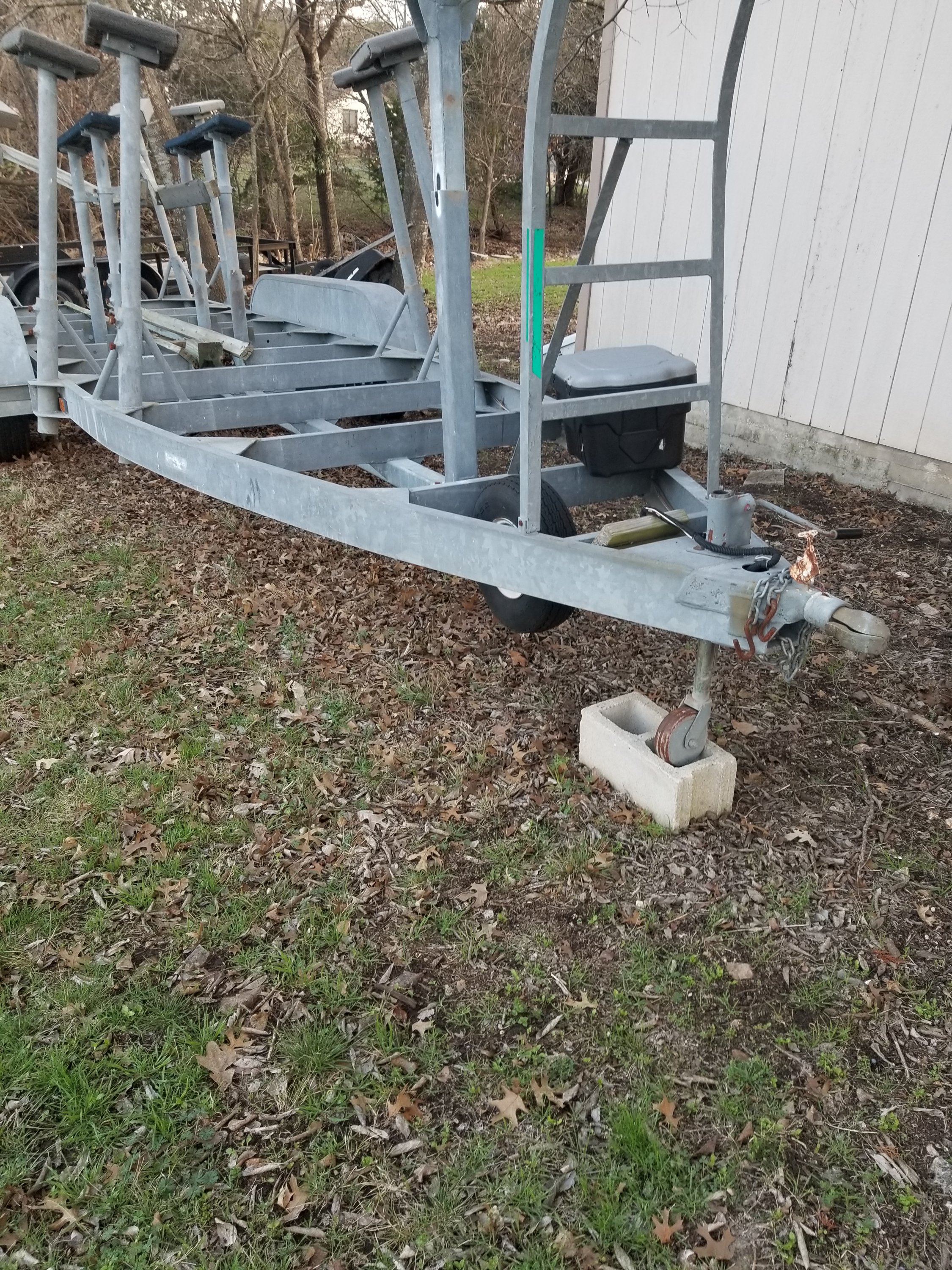

View attachment 147169 There should be a wheel on the tongue of the trailer, not just a jack stand
For sure.
IF your trailer already has a tongue extension, but is still not long enough, here is how I designed a workaround. I would not use this if the trailer had no tongue extension:

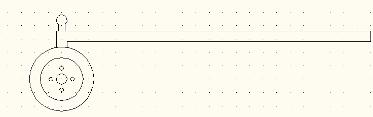

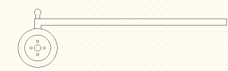

This is a quick sketch of the extender that the local sailing club uses. Picture a ball coupler at the right end of the 2" square tube. One of these can be fabricated to any length you want.

This is a quick sketch of the extender that the local sailing club uses. Picture a ball coupler at the right end of the 2" square tube. One of these can be fabricated to any length you want.View attachment 147309
Thanks Jim. That is exactly what I was thinking would be the best of all worlds — support for tongue weight but the control of a rigid extension. I assume the extension could be 10-15 feet?
Aug 22, 2017
1,609
Hunter 26.5 West Palm Beach
It could be as long as you want. It could be made in two pieces that bolt together for easier transport. It could be made in modular sections so that you could choose to assemble as many pieces as you want, depending on how long it should be for a particular ramp. The possibilities are endless.
I would probably start with making it the maximum length that I could carry easily on the boat trailer. 10-15 feet sounds reasonable to me. Stock length on 2" box tube is usually 20 or 24 feet, depending on who you buy it from, so that sort of just works out well for this application. You probably will need about 4 or 5 feet to make up the A-frame under the ball hitch.
Edit:
If you do have one of those things made up, I would have the width of the axle at least 1-1/2 times the height of the ball hitch, to prevent it from wanting to tip over when turning.
