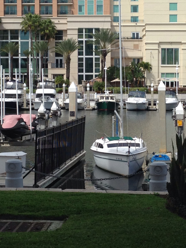

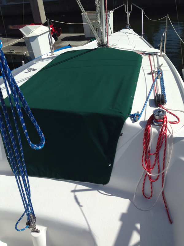

While I'm asking please since I'm new here I hope I'm doing ok!! I purchased the boat for 1400 in the water with rubrail repair 30 bucks, new sail cover and hatch cover 300, Bigfoot 9.9 mercury electric start with charging can eat off this motor almost no hours maybe none for 800,cushions recovered 500, new mainsail 600, all new running rigging 300 and I spliced myself...and a great condition trailer made for this boat 800...think that comes out to 4,700 and almost everything has been replaced that matters the
most is this a good deal or not????

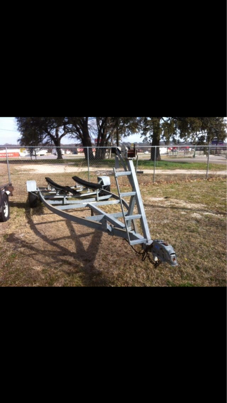

Thought about this a bit and would like to offer these additional suggestions.
Tongue weight, with no boat on the trailer there will be excessive tongue weight. This would not be an issue except that you at the upper end of the limits for your towing system and on a front wheel drive vehicle it makes it even more of an issue. I'd suggest removing the jack post and ladder and strapping it to the rear of the trailer. You are not going to need but 100# of weight on the hitch and I'd bet the empty trailer is twice that. It is only four U bolts to remove so no big deal.
Tire pressure, normally the inclination is to put the tires at the max pressure the tires are rated for. At 35 PSI the tires are going to bounce all over the place and after 1,000 miles they will have rattled the filings out of your noggin and will exacerbate the tendency of the trailer to try and pull the tow vehicle around curves. I'd start at 25 PSI and watch them if the tires seem to be getting warm put a little more air in them
I had earlier recommended removing the uprights on the pictures of the trailer posted they are already gone where are the lights and plate mounted?
If you can get the thing shipped for $250 it very well may be worth the money to avoid the hassle. Fort Worth to Tampa is at least 16 hours on the road with no trailer; with the trailer it will be more than 20 hours. Consider the extra gas, probably an extra night in a motel, wear and tear on the car, etc.. You are not likely to save much money doing it yourself though you are certainly within the realm of suitability for doing so.
Despite all that I'd likely be headed east with the trailer behind me were I in your situation.
