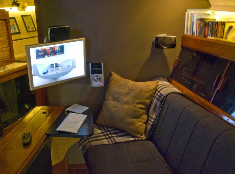

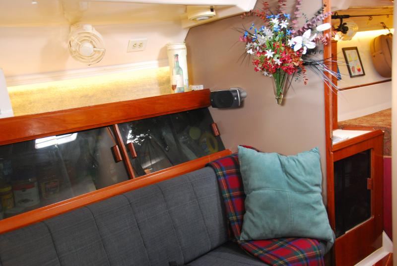

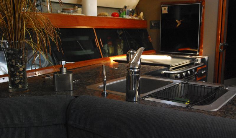

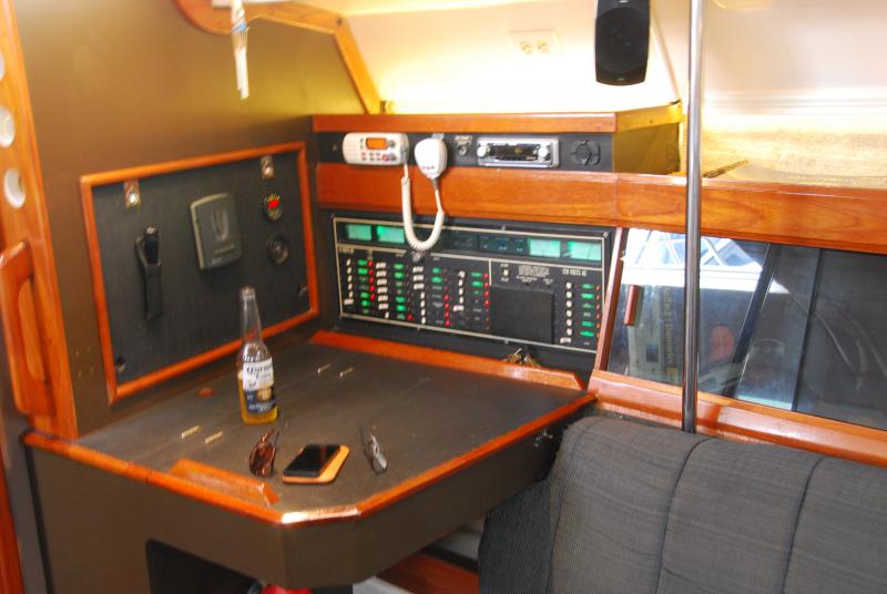

Nice job on the counter top Rick, and the stainless door hardware looks good too.
Hope my spouse does not see those pics this year.........
Jul 1, 2004
567
Hunter 40 St. Petersburg
Thanks.
It's all Home Depot (and the like) and done on the cheap.
Still, it's a butt-load of labor.

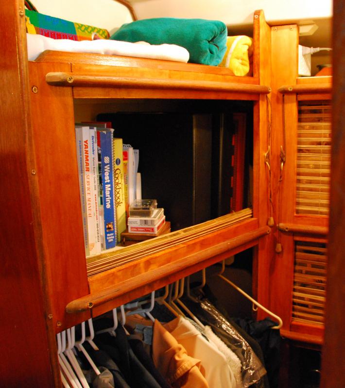

Rick,
By the way, I read somewhere that someone converted their forward head into a hanging locker. That might be worthwhile for you, especially as a liveaboard.

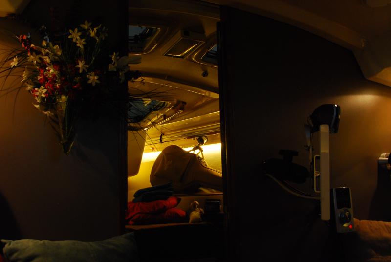

Yup, BTDT.
We first converted the forward head into storage (first pic.)
Since then we've removed the forward head bulkheads entirely and are remodeling a larger v-berth space (second pic.)

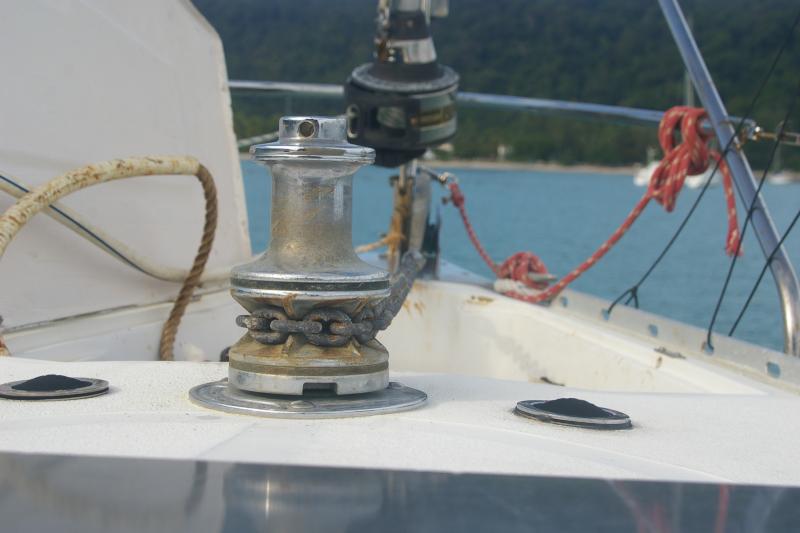

Hey Guys, no need to destroy the anchor locker or get fancy to install a windlass on a H40. Just install a vertical unit just aft of the locker lid and it works fine. This has the benefit of putting the windlass motor inside the V berth where it stays dry, away from the chain and will last 10 times as long as in the chain locker. Did mine in San Diego in 2004 and no problems, am now in SE Asia, basically live on the anchor all that time and distance. Consider if you use the full depth of the bow for the chain you have to fabricate a watertight bulkhead to keep the V berth dry and in any kind of sea the anchor locker will be full of water from the drain and lid. Do you really want to carry x hundred litres of sea water up there? See pic attached.

Rick, your pics show a stunning boat! Well done. I remember the first time I saw the V berth thinking it looked cramped. What was involved in making that area larger?
JWC, nice windlass. I'll remember that!
