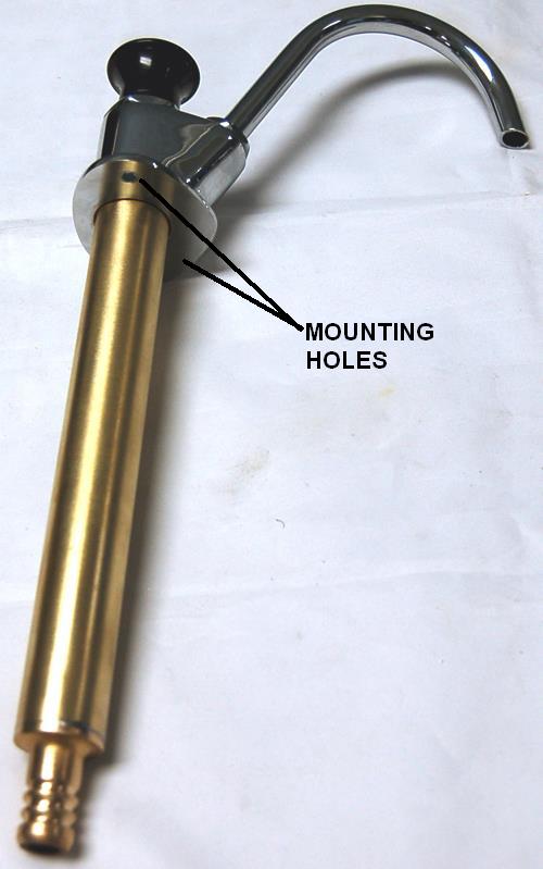

I recently upgraded our dry cabin in Alaska with a Fynspray pump, WS60, all brass. Within three weeks it became very hard to pump, and we sent it back for a replacement. The same thing happened to the replacement.
Has anyone else encountered this problem? If so, how did you fix it?
We have ours mounted centered in a regular double kitchen sink, stainless steel. The barrel is secured to the wall under the sink using a stript of galvanized plumber's tape. This has pulled some zinc out of the brass, but I don't know if that has extended through to the inside to of the barrel or not.
I don't want to order a service kit if I don't need to, but really would like to get this working.
Thank you.

I'm presuming you're using plumber's strapping to secure the pump barrel under the sink. I would suspect this is your problem as you can exert a lot of force using wood screws with plumber's strap. I also note the Fynspray instructions for the repair of this pump say not to use any tools on the barrel. Sounds like its not designed to absorb any forces.
I'm curious as to why you're strapping the barrel under the sink in addition to using the mounting holes on the pump.

<chuckle> A lot of people in the interior of Alaska use marine products such as galley pumps in their cabins to make life without running water easier. We're not under water yet, unless you count snow.
The pump is not mounted through a countertop, but directly to a stainless-steel sink, which is not thick enough to keep it from wiggling during use. Hence the extra bracing farther down. I don't think the bracing is too tight, but will definitely check to make sure.
I talked with our local plumbing guy, and he said yes, the galvanized strap could strip the zinc out of the brass, but yes again, three weeks to a month is awefully early to see any ill effects.
The pump is behaving itself again...for now, but I'll keep everything in mind should any further problems arise.
