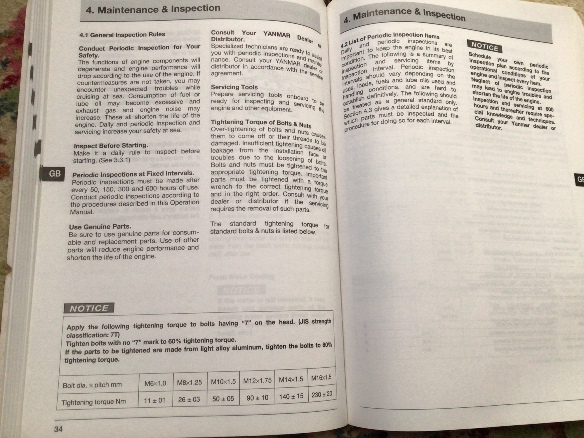

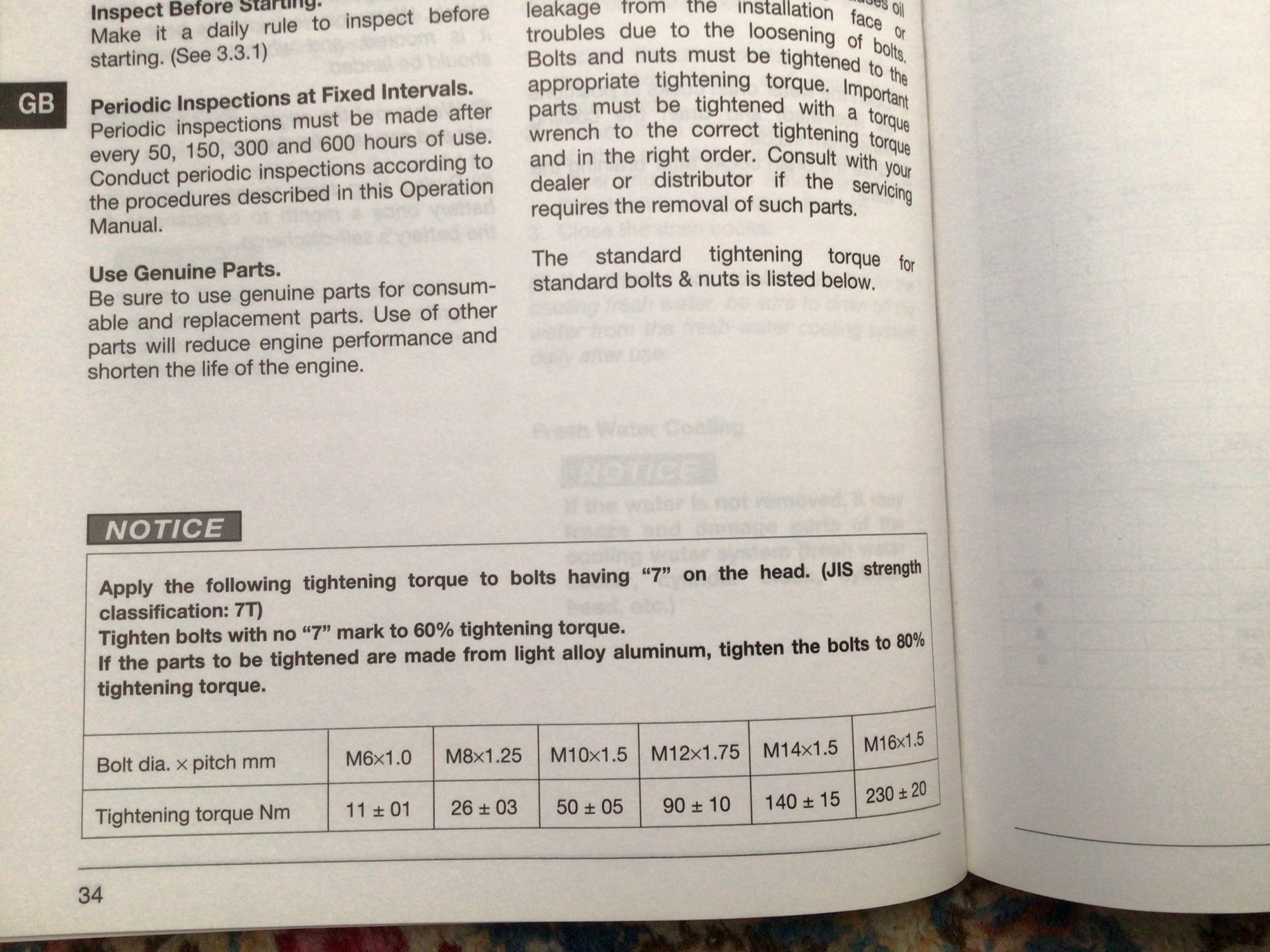

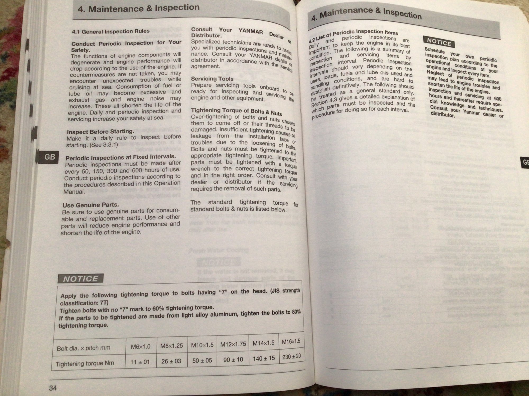

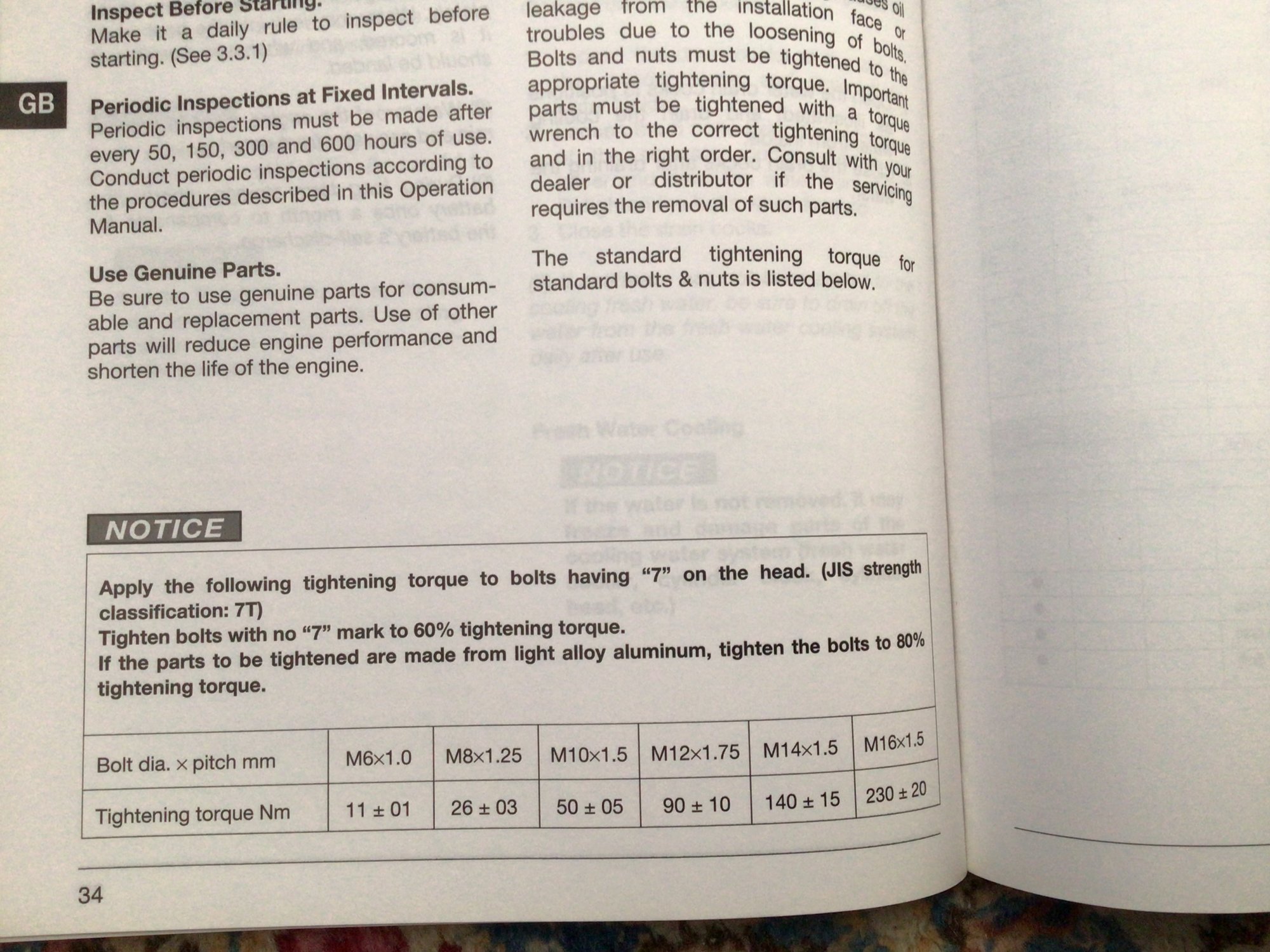

Not sure if you have received the manual from dlochner yet, but I was on my boat this morning and looked through my manual for you. Here is the page that ”mentions” torgue procedures from your Yanmar 3GM30F.
Hope this helps.
Very helpful, thanks!
