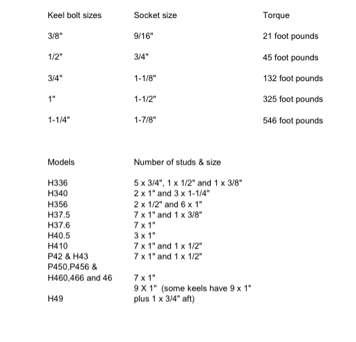

Can anyone tell me what the torque settings are for the keel bolts on a 2004 Hunter 41?
12,565
someone on here posted this years ago….
I kept a copy on my computer.:beer:
Likes: Artoes
May 28, 2015
33
hunter 460 Stuart
Great post, I had the 460 and custom built a wrench to tighten these 1” bolts as down deep and no swing for wrench. I bought a 1” bolt socket at auto parts, got a machine shop to cut it in half, top and bottom, then weld in a piece of pipe between the tow. Hence, a 4’ long deep socket wrench.
