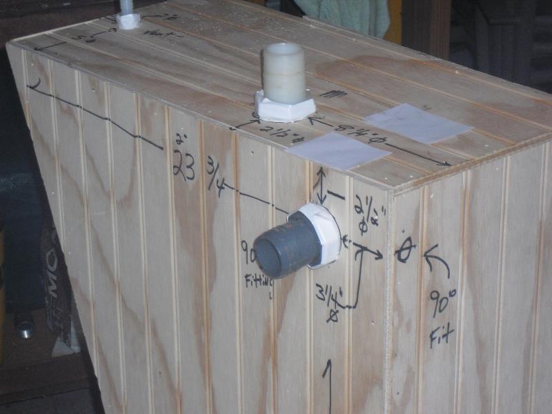

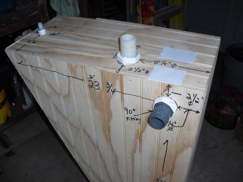

sailski, I too had a 1977 boat with a direct discharge, that I did over this winter. I chose the head direct to the top side of the tank, with a whale y valve, I asked for and ronco installed a drop from the top tube for pumpout. The way I installed was mentioned earlier, y valve posiion 1, straight up to pump out fitting on deck, y position #2 to a macerator and out the hull discharge.When its closed in the locked position toilet pumps to the tank. I wanted to add asecond whale y valve and have the capability to also go straight out, I used the primo 1.5" sani hose and its a bear to bend so I really could not fit the straight out option. U see pics of a template tank I made to make sure it would fit b-4 I purchased. I think Rich from Ronco(very helpful) said it was a catalina sailboat tank, its 28 gal and is narrow at the bottom wider towards the top, the real tank has a nice sweep moulded like the shape of a hull. They will place the hose outlets any where u want. I Chose the toilet inlet, on the top side, and a downdrop tube for discharge out of the top. U might see a 5/8" vent in the rear. I went to the Ronco site there were hundred of configurations. I was able to narrow it down by only considering 25 to 32 gallons. U can see the tank in position in 1 pic, I forgot to photo the real tank, oops. Sorry so wordy but there is a lot of info to absorb. good luck on the install and if I can help u out just ask.... Red

Hey Red,
Thanks for the detailed input! 4" on center beaded siding for a template tank? Nice!
Lotta good info here. I want to dig into it a little deeper tomorrow, find the Ronco website. The tank you chose is close to the one i am looking into at the "plastic mart" website with a taper to fit the hull shape but i think they may offer a more extensive selection at Ronco.
I really appreciate your offer of further help. I may well take you up on that as I progress.
