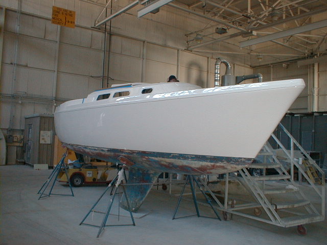

Greetings everyone.....
Has anyone painted the top of their boats?
My S2 is starting to show her age, and it was recommended that we clean the top of the boat and paint it.
The top of the boat shows cracking and its just, like I said, showing her age.
Thoughts?
