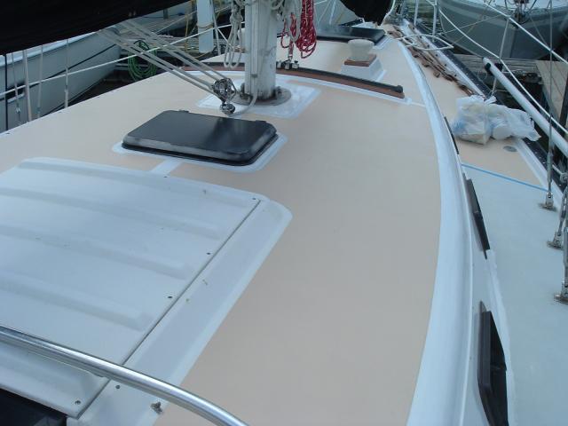

Did you try a very light wet sanding of the gelcoat on the decks and cockpit? You might be surprised how it will shine with a little wax after that. I did that and then painted the non-skid in the first go around.

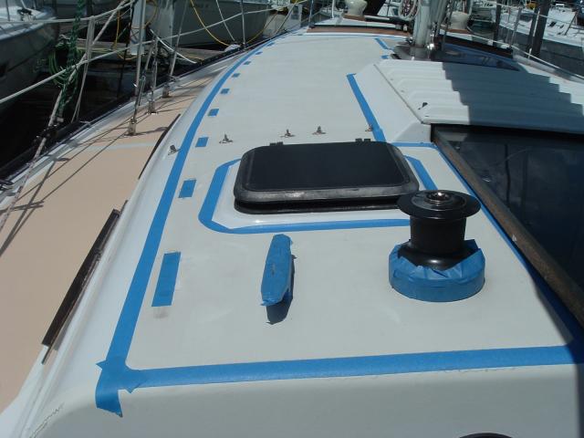

Eventually I had to paint the gelcoat areas. It is easiest if you also do the non-skid as part of the project. Then you can paint and not worry about the gelcoat/non-skid edges. I masked the toerail and some cockpit hardware and wood trim. My portlights were out so that was not an issue. The hardest part are the cabin sides, have the right paint(I used Interlux Toplac) and do not paint in the sun. I rolled three foot sections and immediately tipped with a good brush.
I used Interlux Interdeck for the non-skid. The masking is the time-consuming part. I just slathered it on with a brush, no real need for a roller and there are no brush strokes.
