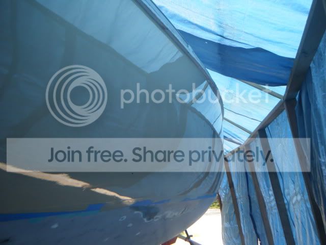

Any recommendations on an epoxy primer?
How well will this primer hide small imperfections like hairline cracks or old paint checking? If at all.

Epoxy primer like Alwgrip is EASY to spray with a 3m PPS primer gun and has moderate to high health risks
It will wet sand with easy and give you a great starting point for the color
ANY TWO PART PAINT HAS EXTREME HEALTH RISKS
Just opening a can of Perfection or Alwgrip is a respirator event and spraying it requires
Truth 3: Wearing a respirator is essential when using isocyanate-containing paints but you need to ensure:
It is the right type – only air-fed breathing apparatus is suitable for isocyanate spraying (filtering face masks are not acceptable)
Given the risks i went with roll and tip and after 3 season in the water it looks like day one
